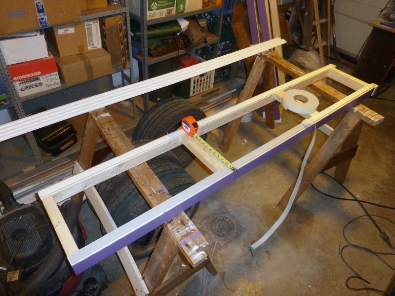

OK, for all you guys on here that insist on worshipping me as the Carpentry God that I am (lol!), here's a good example of "thinking ahead" in my construction that I want to show you... :D
Each of my columns are attached to the wall using only four 3" drywall screws, one in the center of each of the four crossmembers in the framework. Because each column is centered over a seam between the wall panels in order to hide them, I have to run the screws through the center of the crossmembers because that's where the stud is located behind the wall to screw in to. I was worried about this manner of mounting, because the vertical sides of the columns are not attached to the wall in any way; I was concerned that heavy doses of LFE in the theater would cause the wood frames to vibrate and rattle against the wall. I didn't want to glue the frames to the walls, because I wanted them to be removable if need be in the future, without damaging the wall panels behind them.
My solution: I bought a few rolls of truck camper-mounting tape at the hardware store (used to seal the seam between truck caps and the truck bed) which has adhesive on only one side, and applied it to the back of the side members of each of the seven columns... the foam will provide a thin padding between the wall and the frame, and prevent any rattling during an explosive movie or when playing bassy music... :rock:
Am I be smartz or what? :cool:
http://troyfrey.com/forum/flood/camperfoam.jpg
Aerodude73 01-03-2012 02:55 AM
Ewe sur iz smartt Troy!:whip: ;)
spaceape 01-03-2012 03:01 AM
Never hurts too think ahead. Good work. :thumbsup:
