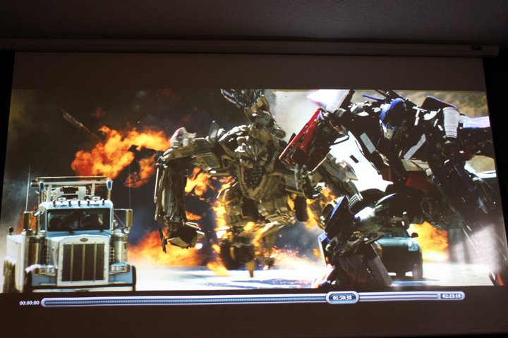

Here's a repost of a few of the shots I took over the last few weeks. theres a mix as some are either from a streaming, 1080p, 720p source, I love my HD DVD but either the projector or receiver is causing a handshake issue causing it to default to 720P with hdmi. when I go component my player stays at 1080 but only gives me 2ch of sound so I've chosen to run it with the hdmi at 720P and full sound. All were taken during the day and there was some spill lighting hitting the screen, I changed to a darker curtain in the theater area so that's taken care of now.
Avatar - 1080P - Blu-ray
Transformers - 720P - HD-DVD
Last Starfighter - 720P HD-DVD
Ice Age 4 - Vudu - HDX

WOW !! job well done. can i hire you for my own project?
