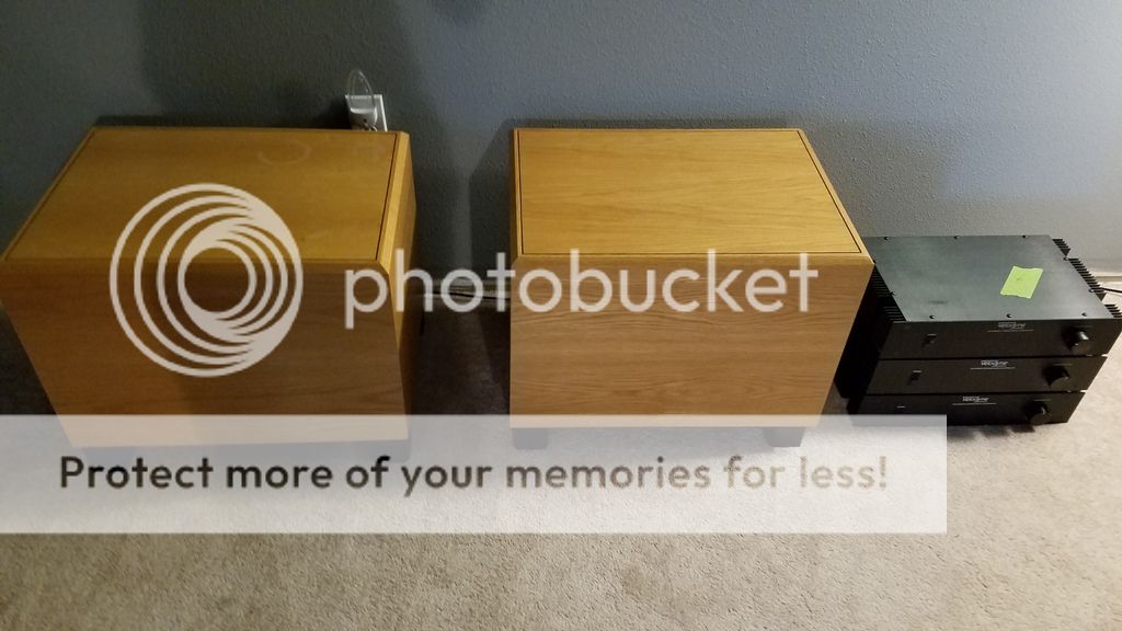

Pulled and ready for sale

At the moment, I have the whole set listed at $1,000 on Craigslist. I have seen the ULD 15 set recently go for around $400 each, and the amp only for around $200. Having the matching set I hope is worth something by itself.
I may not get that much, but as long as I get $700 to cover the cost of the SVS', I'll be happy.
I am going to keep them at $1,000 for a few weeks on CL. I want to see if I get any action over this weekend at $1,000, but to anyone from this forum that might want them, local pickup only (western WA State), I'll do $800 after this weekend.
