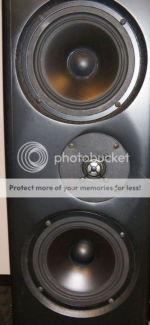

The two BP2000 speakers are mirror image of one another. One has the front tweeter and the subwoofer on the right side and the other one has the front tweeter and the subwoofer on the left side.
The Left Speaker With Original Mid-Woofers and New Tweeter
The Right Speaker With Original Drivers

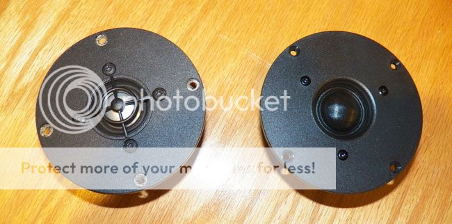

REPLACING THE TWEETERS
Each BP2000 speaker has two identical tweeters, one in the front and one in the back. Their location are between the two midrange drivers in an MTM type arrangements. One tweeter is placed toward the left edge of the baffle and the other tweeter is placed toward the right edge of the baffle on opposite side of the speaker. The tweeters are placed closer to the edges of the baffles in order to decrease the distance between the two midrange drivers. This has the effect of reducing lobing errors and improving the off-axis response of the speaker.
Tweeter Requirements:
  • Driver Diameter: Exactly 3 inches.
  • Impedance of the driver must be 6 Ohms.
  • Sensitivity: >= 90dB
  • Maximum Mounting Depth: 3 inches.
  • Frequency Response: The upper limit should preferably be beyond 20,000 Hz.
  • Power Tolerance: Sufficient power tolerance.
  • Optional Requirement: The stock tweeters are aluminum tweeter. I preferred to replace them with silk-dome tweeters.

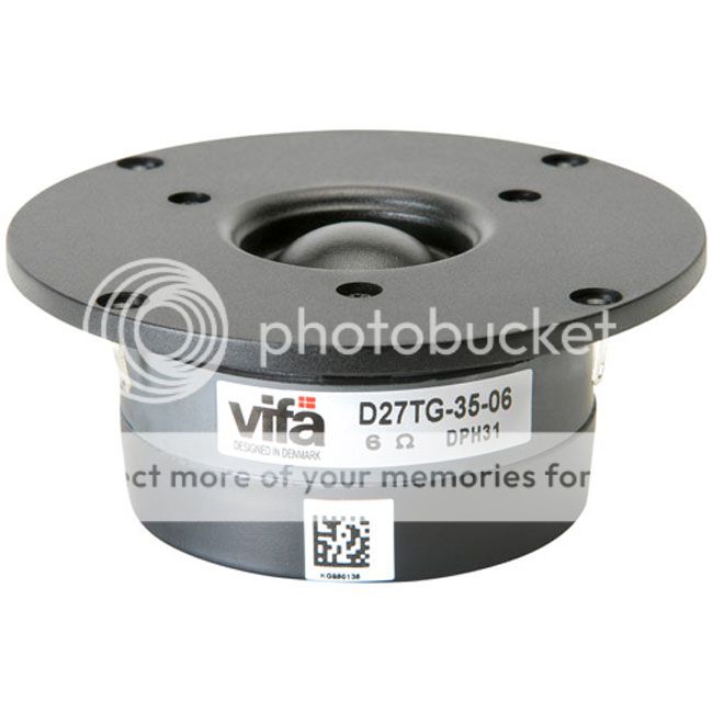

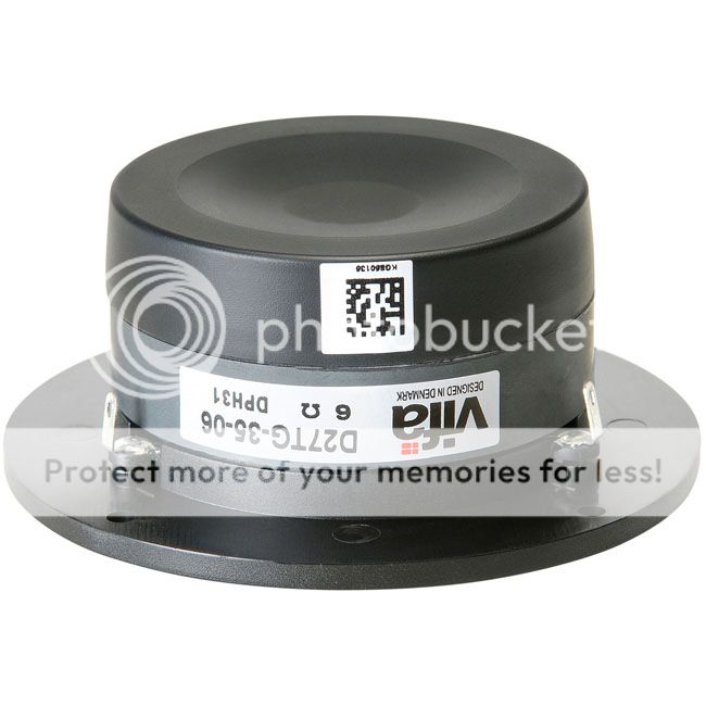

After an exhausting search on the Internet, I finally found the Vifa D27TG-35-06 1" Silk Dome Tweeter to meet almost all of the above conditions.
Vifa D27TG-35-06 Tweeter Specifications:
Power handling: 25 watts RMS / 50 watts max
VCdia: 1"
Impedance: 6 ohms
Re: 4.7 ohms
Frequency response: 880-30,000 Hz
Fs: 880 Hz
SPL: 92.6 dB 2.83V/1m
Overall diameter: 4.10"
Cutout diameter: 3"
Depth: 1.25"
The Stock Tweeter (Left) and the New Wifa Tweeter (Right)

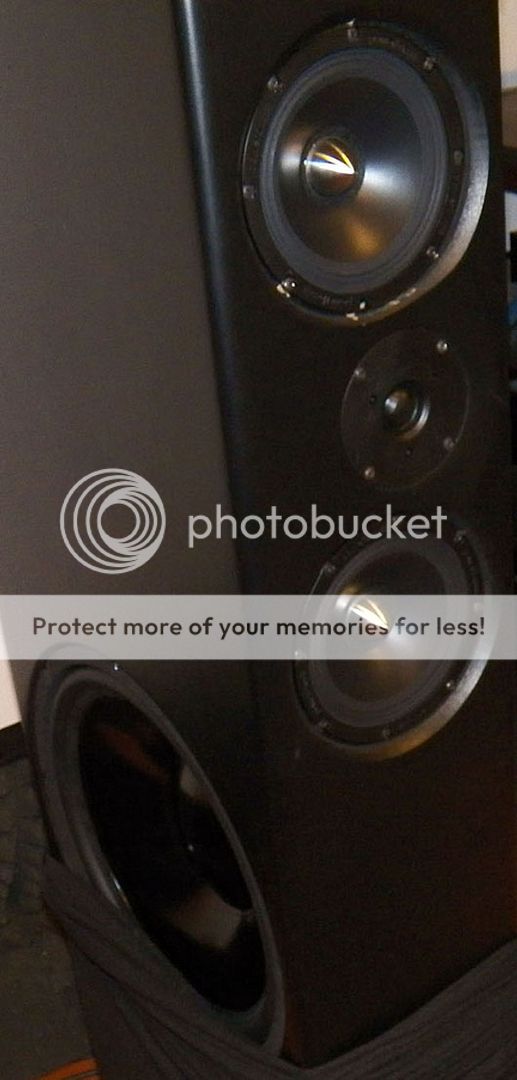

REPLACING THE MIDRANGE DRIVERS

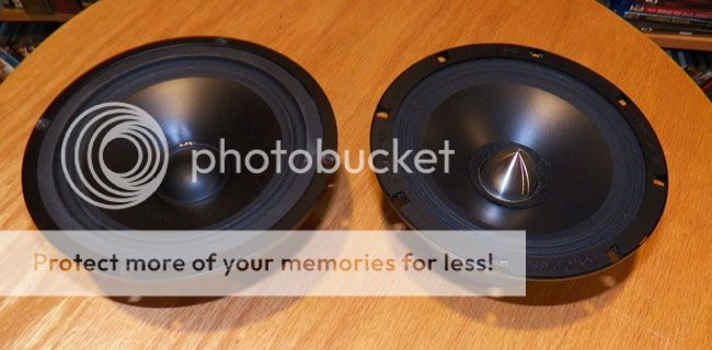

Each BP2000 speaker has a total of four midrange drivers. Two of them are in the front and two are in the rear of the speakers. They are identical and are wired together in a bipolar configuration. The impedance of each driver is 4 Ohms. The front and rear drivers are isolated from each other by a solid bracket between them. As a result, the mounting depth of each midrange driver could not exceed 3 inches.
Requirements:
  • Driver Diameter: Exactly 6.5 inches.
  • Impedance of the driver must be 4 Ohms.
  • Frequency Response: As wide as possible.
  • Optional Requirement: A driver with Phase Plugs would be preferred.

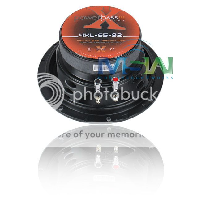

After an exhausting search on the Internet, I finally found the PowerBass 4XL-65-92 4XL-6592 6.5" Midrange Speaker Driver to meet almost all of the above conditions.
PowerBass 4XL-65-92 6.5" Mid Range Specifications:
  • Paper/Laminated cone
  • Aluminum phase plug
  • Accordion style cloth surround
  • Chrome push input terminals
  • Diameter Size: 6.5 in
  • Power Handling (RMS): 100 watts
  • Power Handling (Peak): 200 watts
  • Nominal Impedance: 4 ohm
  • Voice Coil Size: 2 in KSV Voice Coil
  • Frequency Response: 100 Hz - 10000 Hz
  • Sensitivity: 92 dB
  • Motor Structure: 35 oz.
  • Mounting Depth: 2.8 in
Nomex paper (NSV), Kapton (KSV), Aluminium (ASV, AL), Til (TSV), Kraft Paper (PSV).
AL (Aluminium Lock)
KSV (Kapton, Polyimide Film)
PSV (Kraft Paper SV)
NSV (Nomex SV)
BASV (Black Aluminium SV)

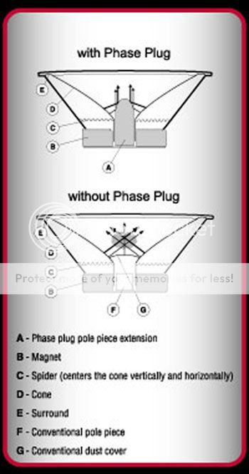

Phase Plug Technology
http://www.preference-audio.com/phaseplug.htm
In any conventional loudspeaker, the highest frequencies of audio emanate from the area around the center of the cone and the lower frequencies are produced by the area of the cone that is farther from the center. In fact, the distance from the center at which a sound wave will come off a loudspeaker cone is directly related to its frequency. This helps explain why larger cone loudspeakers are usually capable of producing more bass.
Due to the shape of the conventional loudspeaker cone, the higher frequency sound waves tend to collide at a focal point. This causes phase distortion and a loss in clarity. As a result, accuracy and transparency suffer. This also has detrimental effects on the realism of the sound environments created by today's high fidelity digital audio and surround sound systems.
The phase plug pole piece extension improves driver performance and clarity by deflecting delicate midrange audio out into the sound space and minimizing distortion producing collisions.
A while ago, I sent the Fostex 206E drivers in my DIY super tower speakers for an upgrade. A new Phase Plug was added to the driver to improve its performance. Read all about it in THIS POST.
Additional References on Phase Guides:
http://www.decware.com/paper79.htm
http://www.decware.com/paper46.htm
http://www.uaudio.com/blog/understanding-audio-phase/

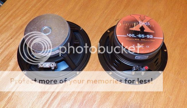

The Two Midrange Openings
The Front Side of the Stock Midrange Driver (Left) and the New PowerBass Driver (Right)
The Back Side Stock the Midrange Driver (Left) and the New PowerBass Driver (Right)

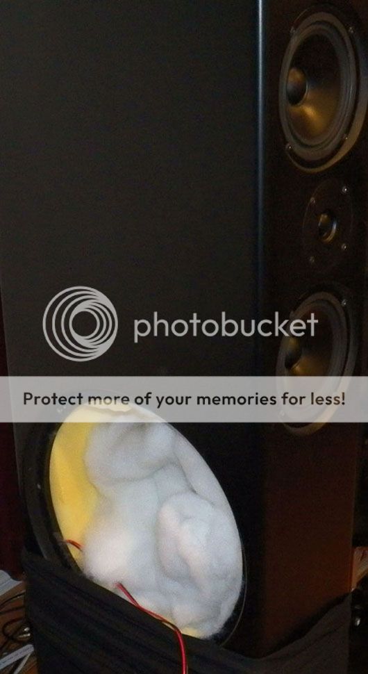

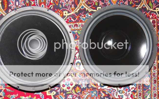

REPLACING THE 15 INCH SUBWOOFER DRIVERS
Requirements:
  • Driver Diameter: Exactly 15 inches.
  • Maximum Mounting Depth: 8 inches.
  • Frequency Response: From around 20Hz to the around 2,000Hz. The typical 15" subwoofer driver extends up to around 200Hz and has a mounting depth exceeding 10 inches. The built-in 15" subwoofers in the Definitive Technology BP2000 are not LFE subwoofers. They are added to extend the low frequency perfomance of the speakers. In that respect, they are different than the Definitive Technology BP7000 series speakers. Although the 15-inch drivers of the BP2000s have their own dedicated 300 watts amplifiers, they have to be given a full-range signal and not an LFE signal. This can be done either with speaker wires or separately with RCA cables. The RCA cables must be connected to the pre-outs for the main (front channels) on the back of the receiver/processor.

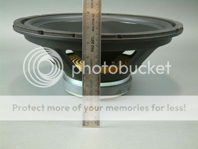

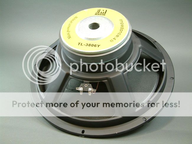

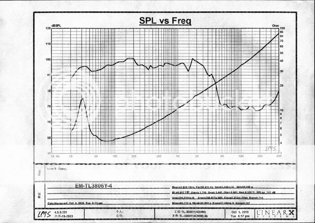

After an exhausting search on the Internet, I finally found the Mavin Model EM-TL3806Y-4 15 Inch woofers to meet almost all of the above conditions.
Mavin Model EM-TL3806Y Specifications:
Rubber Surround
Minimum SPL of 92 dB from 23 Hz. to 3kHz. 89.5 dB @ 20 Hz.
Magnet: 9 pounds
Impedance: 4 ohm
Power Rating: 500 Watt
Vented Voice Coil to help displace heat and improve performance
Cutout Diameter: 13.8125"
Depth: 6"
The 15" Subwoofer Opening
The Stock Subwoofer (Left) and the New Mavin Subwoofer (Right)
This is the picture of the right BP2000 speaker after all the drivers are installed.
