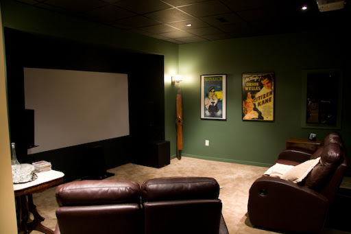

It was a basement build. Here's what it looked like when I started:
Roughly the same angle now that it's complete:

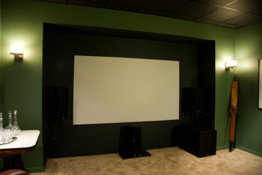

Here's a better view of the screen. It's Screen Gray painted on primed sheet rock. It looks great! You can see my Ascend 340 mains and SVS PB-12 NSD sub. The L/R speakers are on small TV stands.

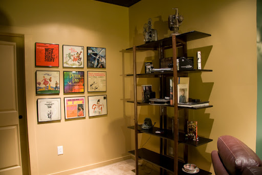

There's a small area to the left of the main HT. I have some movie memorabilia there. The albums on the wall are part of my music collection.

The screen is 120" diagonal. Notice the soffit around and above the screen. That was my solution, it's behind the wall. I wanted to keep the ceiling at 9 feet.

The original plan was to use an acoustically transparent screen. I did a lot of reading over on the Home Theater Shack site. I also ordered a sample of the screen material. At our normal viewing distance, the weave of the fabric was noticeable and distracting to my wife. In order to get the speakers behind the screen, she felt we would have to place it too far into the room. I read at Home Theater Shack about Sherwin Williams Grey Screen being a nice moderate gain paint. We actually use Pratt & Lambert paints, so I took a Grey Screen swatch and matched it at our paint center.
I went to extra care when framing and dry walling the front wall. We primed it with Kilz, then hung the projector and framed the screen. The image looked pretty darn good on the primed walls. I zoomed in just a hair when marking the screen area. I then painted on the screen color with two careful coats. We then checked the image and were amazed at how much better it looked compared to primer. There was more snap and the darks significantly improved. Now came the scary part. Again, I marked off the screen. I then carefully taped the border, then covered the screen area with plastic. I then painted the surround with Black Watch Green, which for all intents and purposes is black. Once the paint dryed, I removed the plastic and carefully peeled the border tape. There were no runs or paint lifts! Whew! All in all I guess I have about $20 in materials in the screen.
