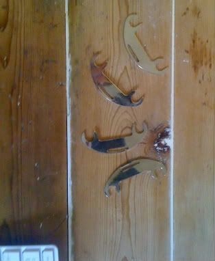

Hmm I'm afraid your talking to a bit of a newb haha! I know about Bi-wiring, but I don't want to do that. Brass Jumpers? Are these the ones you mean? If so what should I do with them?

Yes you just unscrew the posts enough to stick those jumpers in between the two post then screw the posts back down and reconnect your banana plugs into them. Basically you only heard high pitched noise because your reciever was only running the tweeters on the speakers and not the woofers because one set of the post are for the tweeters and the other is for the woofers so when they are connected by those brass jumpers they aren't even getting used.
