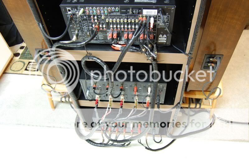

There are many ways to hide or Manage your cables & wires .
Zip-ties , cable wraps & there are more .
Just make sure you keep all the power cords & speaker wires away from your Interconnects when putting them together . Another thing is to not coil any excess in a circle . Make a crazy eight instead .
This is how I did mine , There is a lot of work involved wrapping them , But it looks good .

That is so awesome! ...We can tell you put a lot of work on this, but it's worth it at the end.

That's really neat. but I don't understand why not coil the excess?

Avoiding the coil is helpful in avoiding noise problems. The loops can create a strong magnetic field inside the coil, due to Ampere's Law.
Now, you don't need to really worry about the technical crap...just try to avoid the coils.

Thanks for clearing that up. Now I have to make sure I don't have any coiling in my wires. I hate the having a rats nest of cables so I am always looking for a solution to tidy things up.
