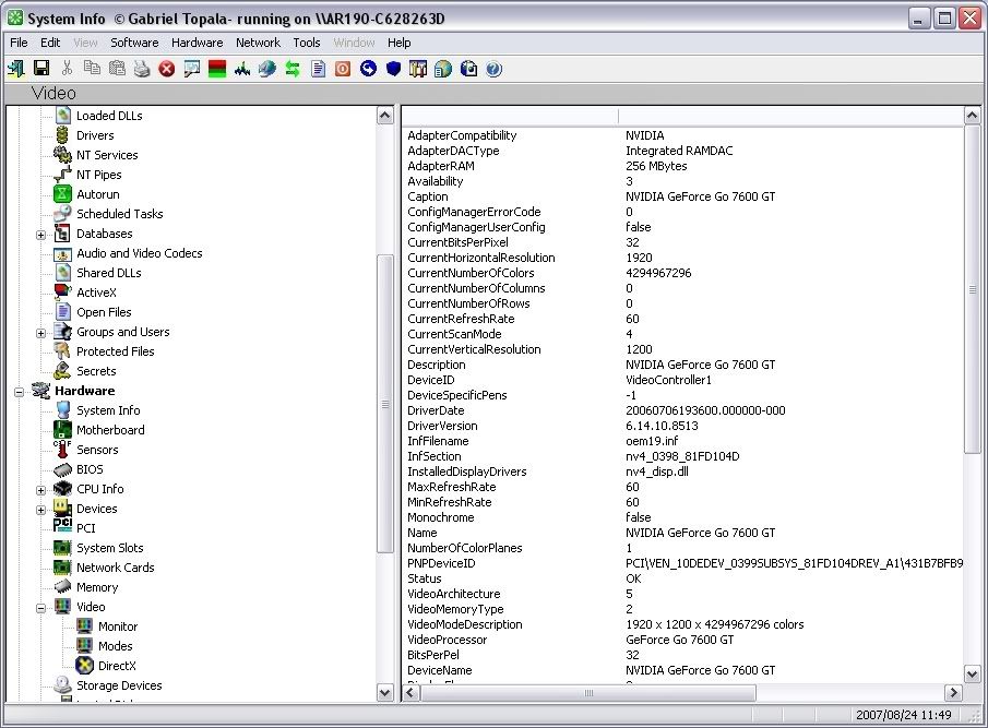

This laptop does have a nVidia 7600 GT dedicated card... I believe.
I know it is not integrated video, never opened the case though.
This very well could be on a card.
EDIT: PCI?
