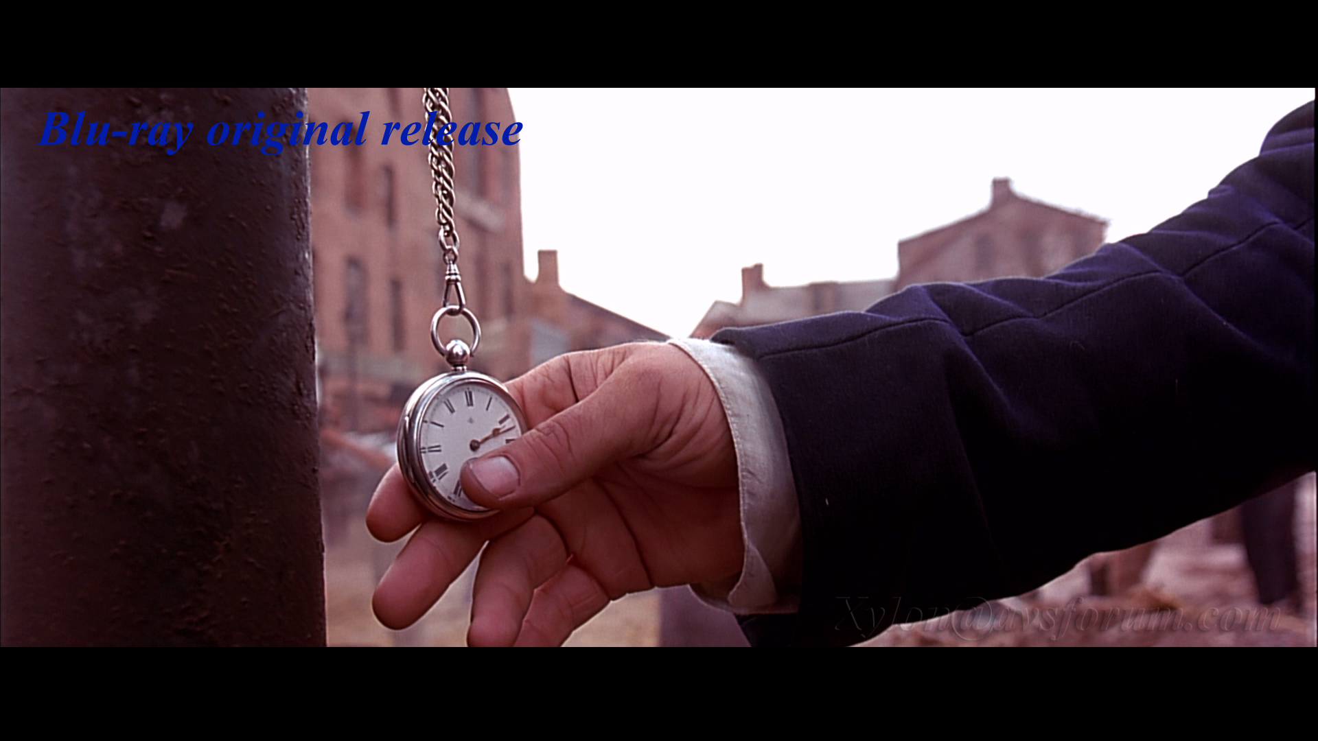

I thought it would be educational and informative to start a thread discussing and showing what the different kinds of anomalies caused by after effects such as edge enhancement (EE), digital noise reduction (DNR),etc. look like. Included are other effects such as aliasing, "haloing", artifacts, dirt, and other unnatural anomalies. This is so that other members can get a true sense of what they really are and how they can effect certain transfers. PLEASE POST PICS AND EXAMPLES if possible. If pics are available of these anomalies from current blu-ray or DVD releases then please post if you have them. I will try my best to keep the thread updated with more accurate information if my facts are a little fuzzy.

DNR and Contrast Boosting:
Gangs of New York (original)
Gangs of New York (remastered)

42
DNR, contrast boosting.
