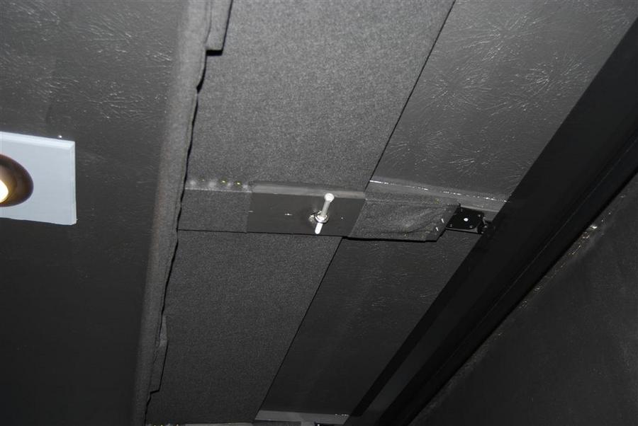

Depending on the situation you can build your own. Take a look at my gallery. It's probably a little overkill but I had the wood and paint laying around and only had to buy the cloth ($15) and hinges ($15).
Bill
hey i really like what you have done... looks beautiful....
do u bring the mask down manually...? and how do you attach it to the top... can see very clearly in the pics....
Thanks. I do have to drop it into place manually but it's somthing I am more than willing to do in order to gain the advantages of having it there. It's attached to the cailing via 3 hinges and it stays locked up with a simple eye bolt that goes through a hole I drilled into it and I just slide a bolt through the eye.
