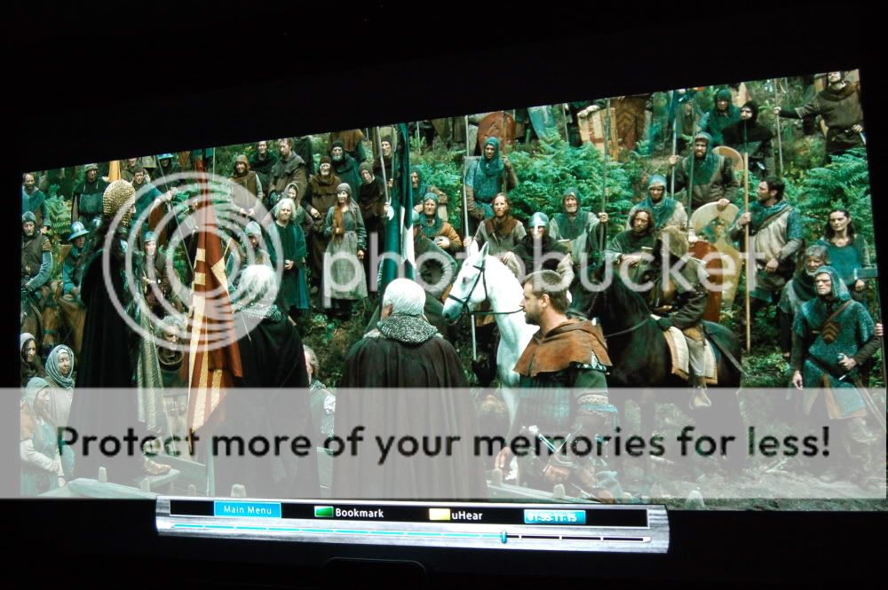

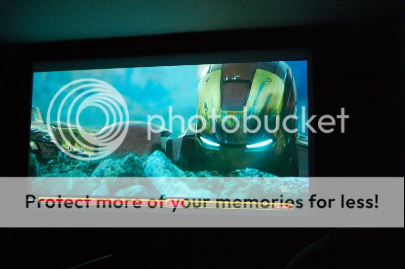

Old 12-13-2011, 01:27 AM   #6
crazyBLUE's Avatar
Aug 2008
Pacific Northwest
89
479
38
Originally Posted by Allforce View Post
How much of a difference does it make in PQ for those of you with PJs and dedicated screens to have the ceiling a darker color? Ours is white and I've never really seen what the problem could be but I read a lot of statements like "I wish I had gone a darker color in hindsight...".
For me there is less distraction from the reflection of light off the ceiling from the screen. The PQ might be a little better but it is the reflections that make the difference for me.
This is when my ceiling was white.
Here is what it is like now with a dark gray ceiling. A darker room is much better then having lighter shades in the room.
