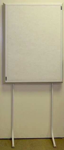

I've only seen them at a couple of shows, but I can attest to the build quality of Real Traps', err, traps. They're very well made, and work well. In fact, this thread reminds me that I need to send some drawings & photos of my room to Ethan and work out how much cash I have available to spend on room treatments.
