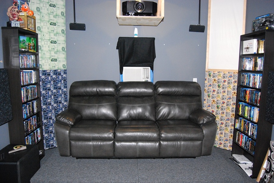

I built 2 platforms using 2"x6"'s and a single 4'x8' sheet of plywood ripped in half. I then carpeted them with the same carpet that I used on the floor. You can see then a bit in this old picture:
