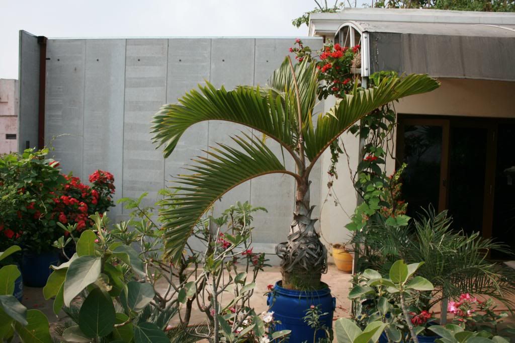

Proposed HT Room area.
Columns set and trusses on.

She sure deserves! all her concern was about not losing her plants....so, had to make an extra effort shifting them to the above floor....which looks like this from below!
I am piling up equipment for the HT. It will be a combo of old plus new....more details about it later.
