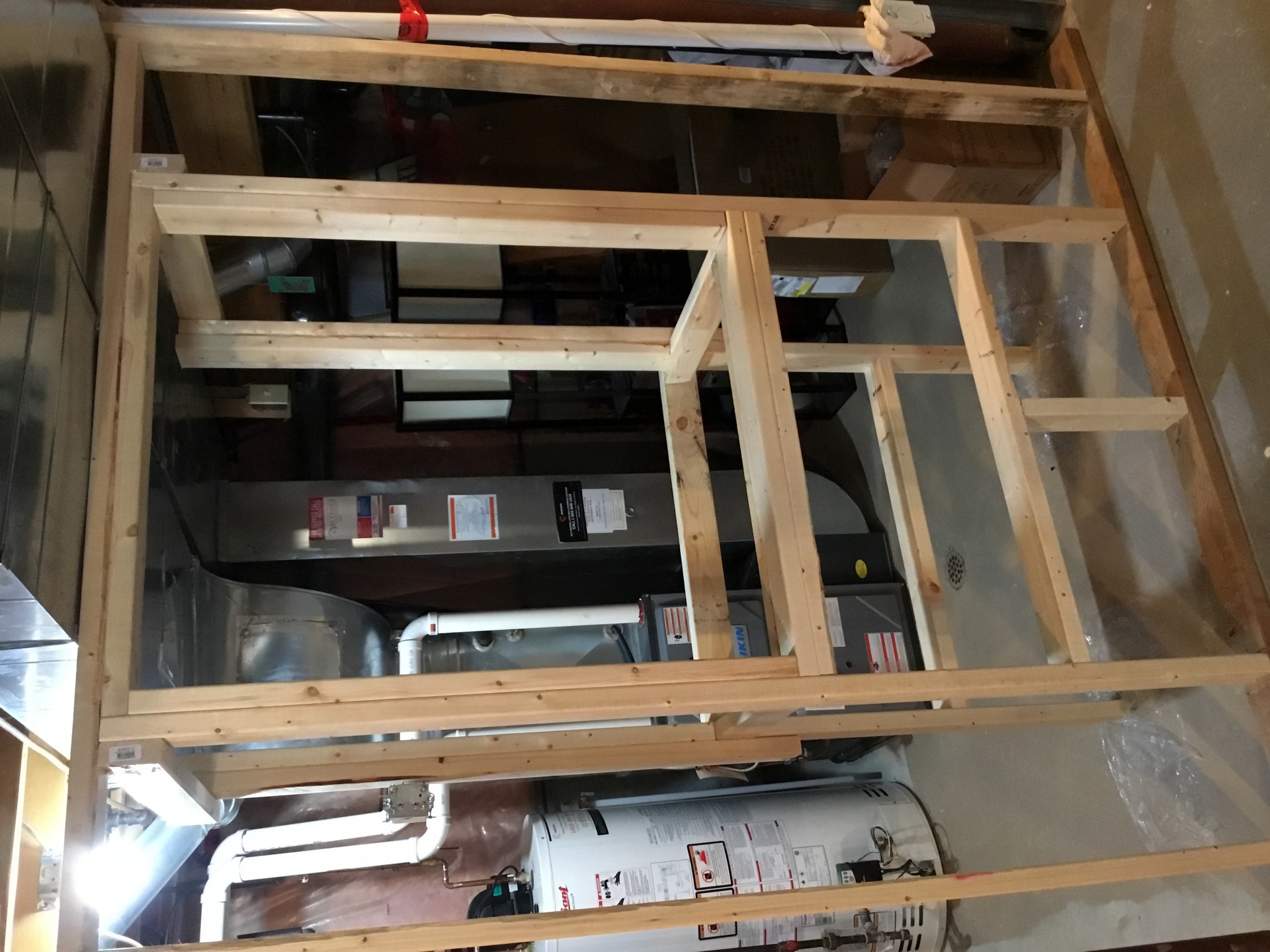

New house, new home theater.
Was quoted $30,000 to finish basement, so decided to do it myself.
Hoping for 7.2.4, we will see what the construction dictates given the hvac.
I have always wanted a theater rack built into the wall. So this is it so far.
Goal here is to show step by step completion. This is going to be a lengthy thread.
I have basic carpentry skills and some working knowledge.
I am going to see how much it will be for me to complete with help where needed or for insurance reasons.
I will update occasionally with $ totals for theater only Including tools; NOT including electronics purchased during build as electronics are personal tastes.

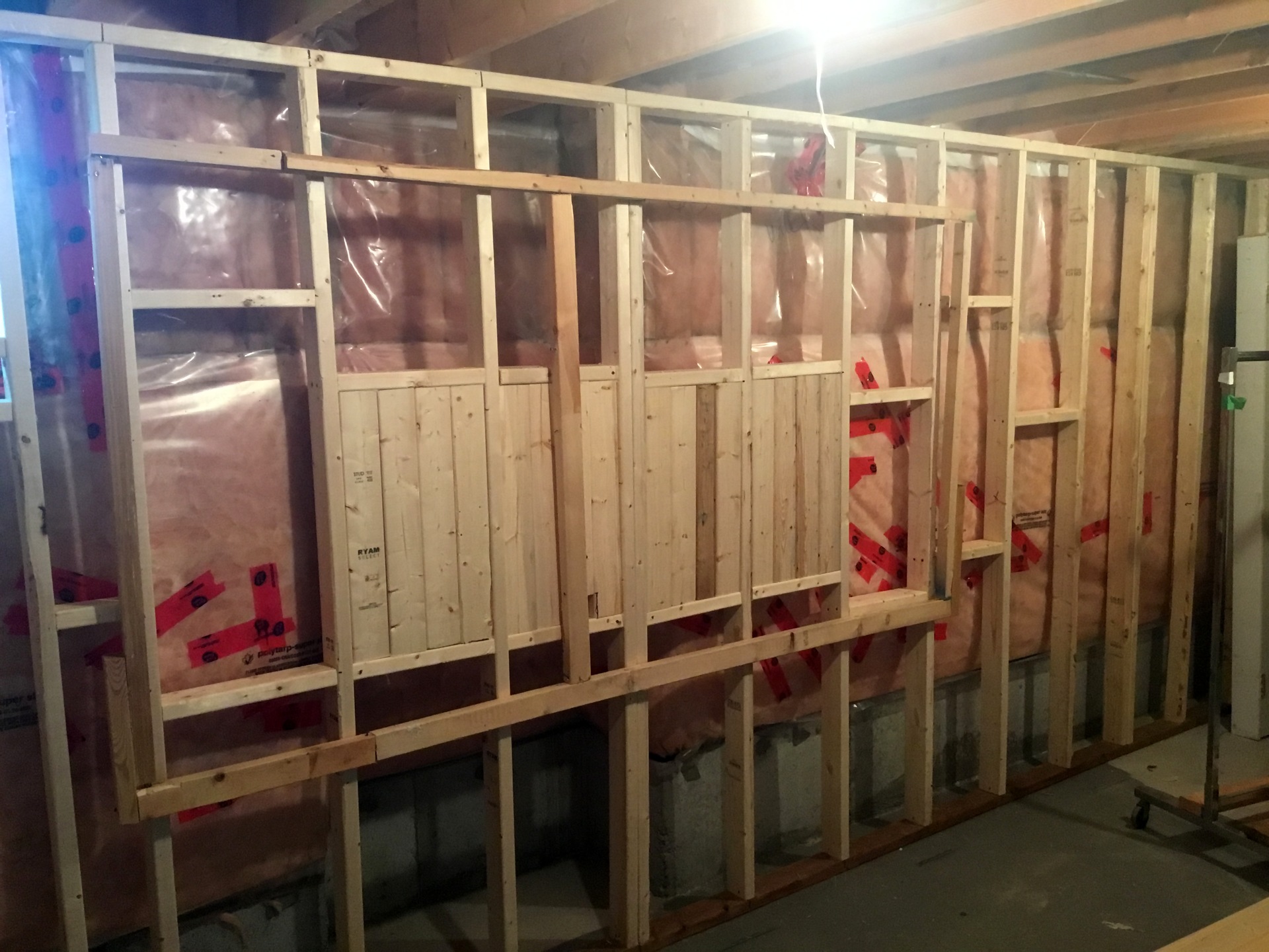

A little more progress today

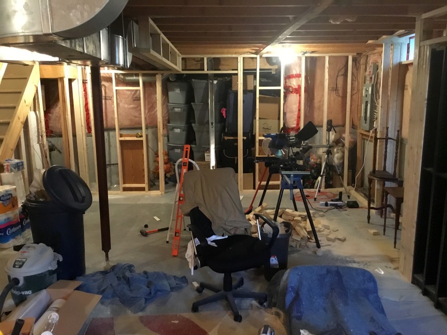

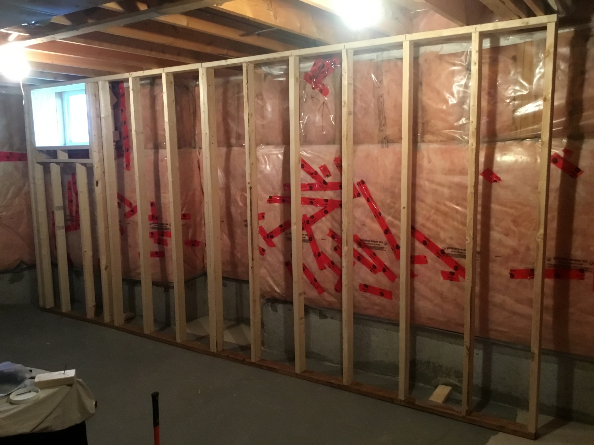

Decided not to put in a bathroom $$$$, I have one at the top of the stairs.
Old 06-21-2020, 01:28 PM   #10
sonic_debauchery sonic_debauchery is offline
sonic_debauchery's Avatar
May 2011
Earth
473
416
221

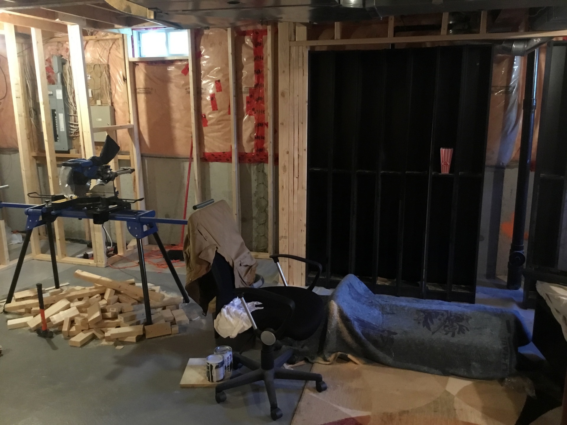

Default Back wall with double doors
Ran out of material, still needs one 16 inch on Center stud.

Redid wall moved back 6 inches at wife’s “request”
Built Mach screen to know where things lie and left an opening for power for a 75 or 85 inch tv.
Used left over wood to build backing for tv mount and lag bolts.

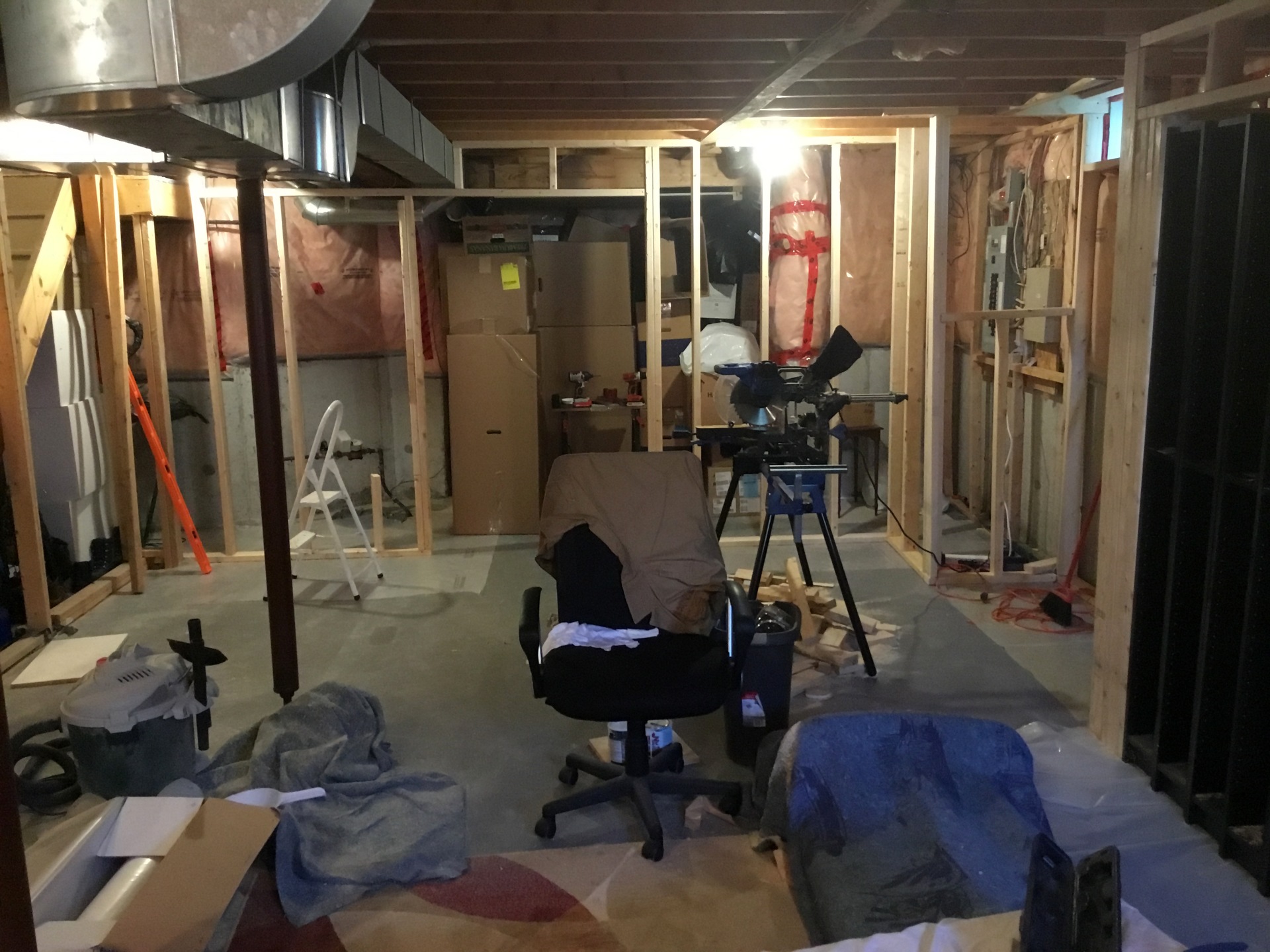

Redid window encasement. Lots of fun used left over wood for tv mount to hard surface.

Wife requested that I move wall back. As usual she is right.
Moved back wall backward 3 feet. Didn’t want to have to build another door frame to hide fuse box, but it is better now.

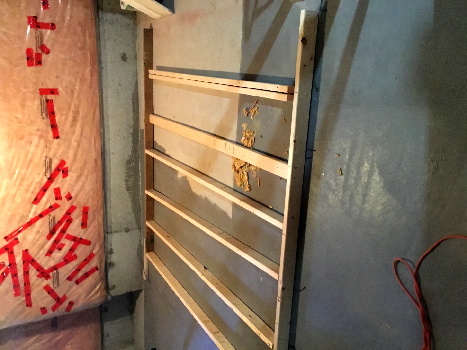

Built back boxes for these..... https://www.paradigm.com/en/in-wall-subwoofers/pcs-82sq
Theater will be 620 square feet now.

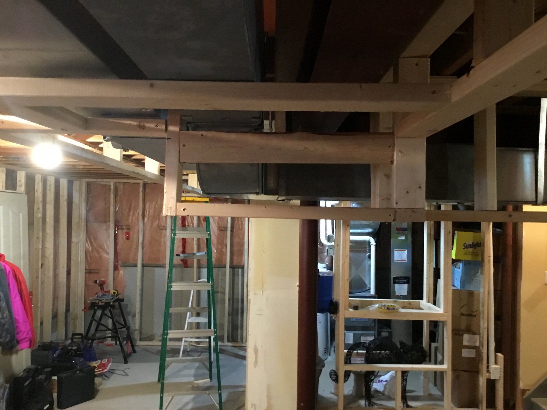

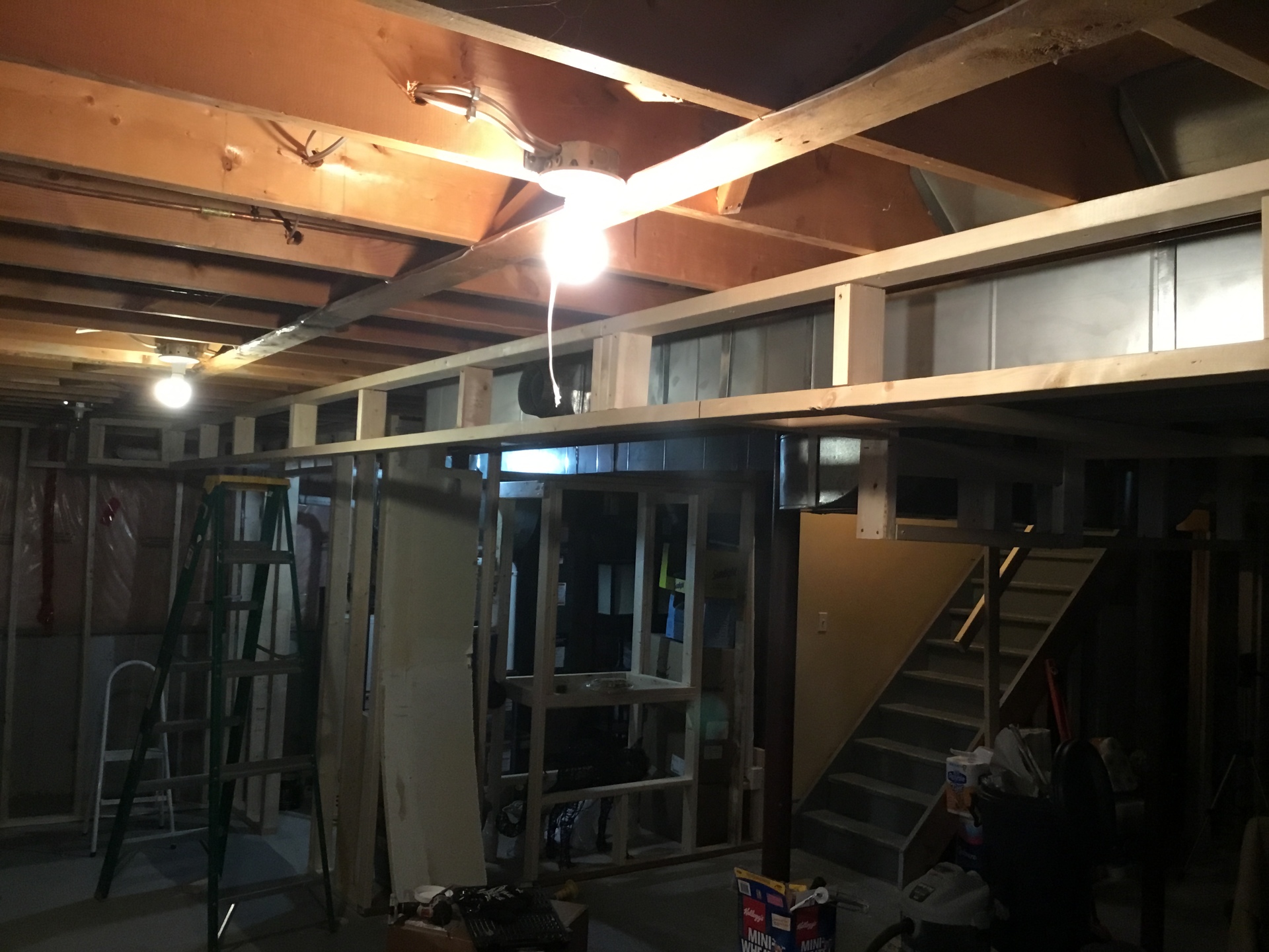

Started ladders for hvac
Have to be careful under stairs due to gas line, I have to run ladders and encasement 11 feet. Gas line in middle so will be challenging.

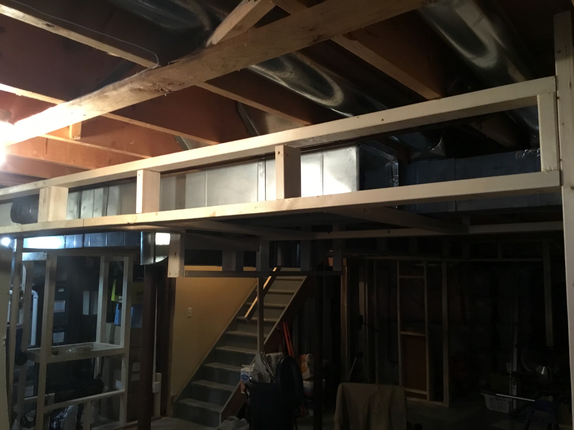

Default 24 ft run
Started getting the hvac framed out. Had to make 24 ft run as you will see in the next set of pictures.
Old 08-05-2020, 09:19 PM   #18
May 2011
Earth
473
416
221

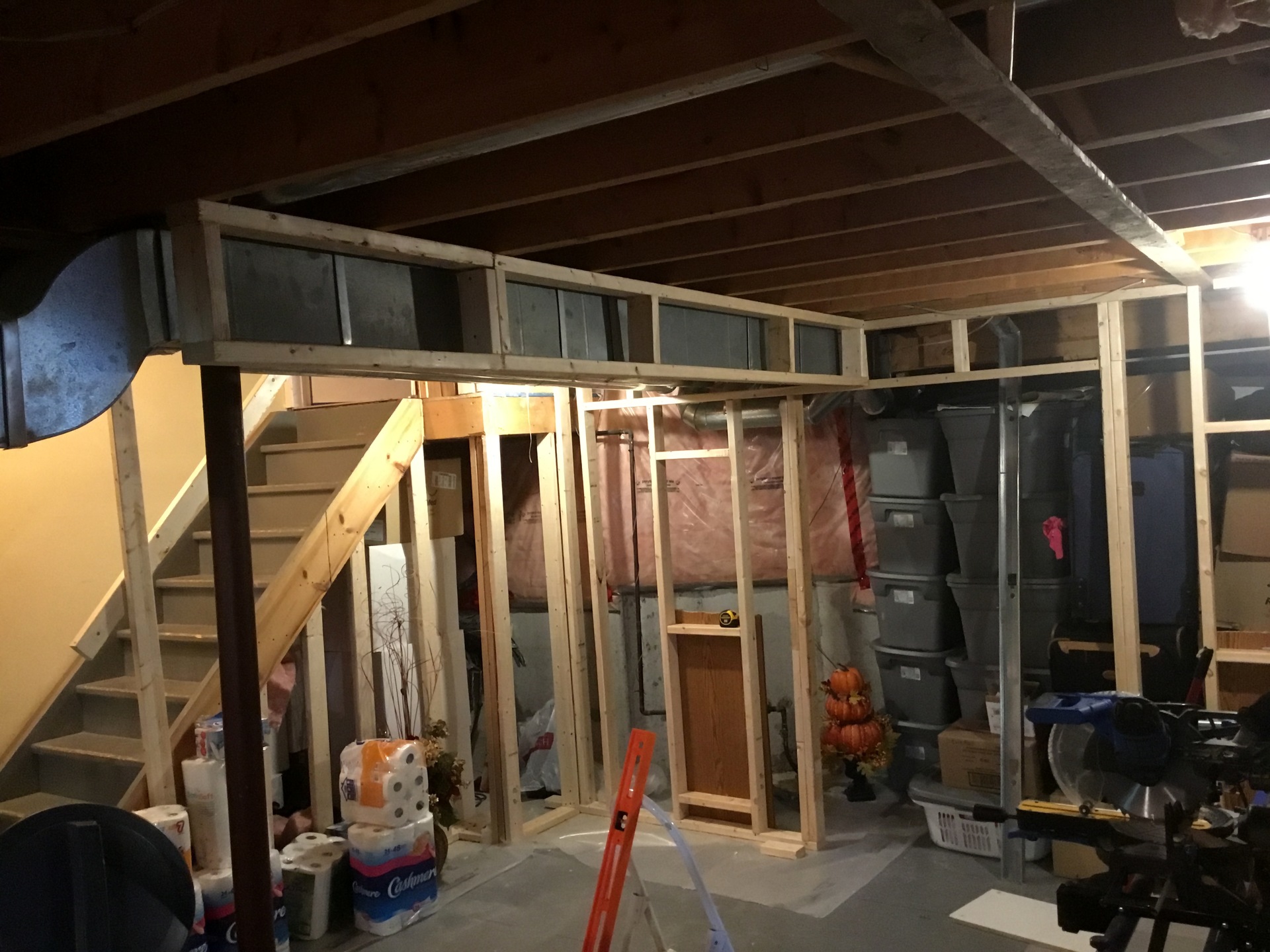

Default Straight and level
Getting a 24 ft run straight and level was fun. The trick........shims.

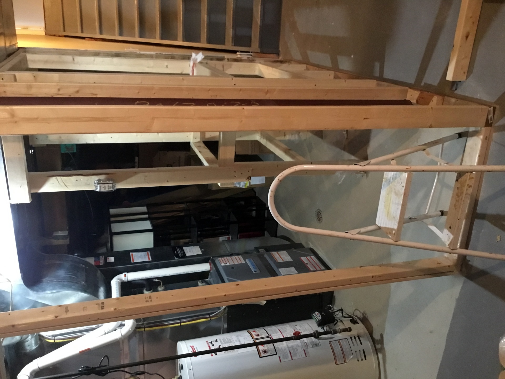

Default 16 inch drop
Had to do a 16 inch drop due to hvac being dipped below metal beam. Gonna be low ceiling in this area, but unavoidable unfortunately.
