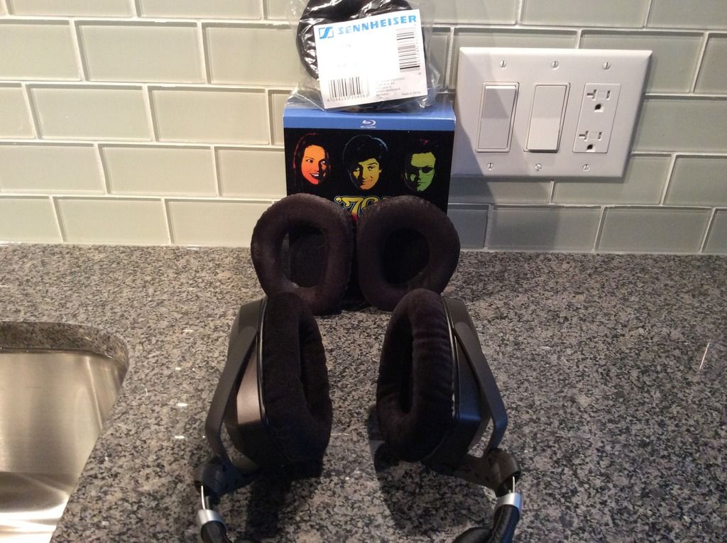

Update!
Here you see the new pads on, old pads behind, & another pair packaged.
Took awhile to get them but it was the Christmas rush so...
After putting the headset on, immediately felt brand new.
http://headphonespares.sennheiser.co...dphones/rs-185
They ship in a very well thick protected cardboard bag. Didn't hesitate to order another 2-pairs.
Wish price was lower.
