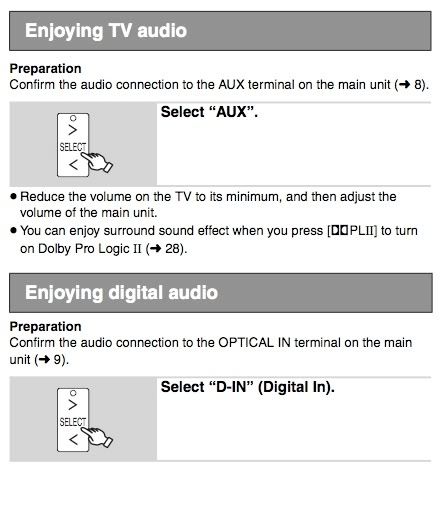

I think you misunderstood me. I said the receiver's input needs to be set to optical, not just the player.
Old 10-16-2008, 04:44 PM   #6
Footloose301 Footloose301 is offline
Footloose301's Avatar
May 2007
Fort Myers, FL
38

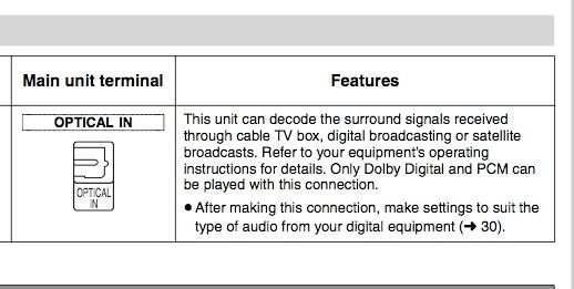

These are from your manual. You need to make sure your receiver's optical input is assigned. Also, your receiver will only support Dolby Digital and PCM. So make sure your Blu-ray player is set to decode everything and transfer as PCM. Do not have it set to bitstream.

Old 10-16-2008, 05:27 PM   #12
My_Two_Cents My_Two_Cents is offline
My_Two_Cents's Avatar
Dec 2007
Wherever I may roam....
40
35
507
I don't believe that is correct. When bitstreaming over optical, you can either send the lossy DD and DTS for receiver decoding or the downmixed PCM, meaning 2-channel. You will NOT be able to decode anything in the player to send to the receiver. Your best solution for listening to surround, is to set the Sony BD player to bitstream and send Dolby Digital and DTS to the receiver for decoding. You won't get HD audio, but it will be better than 2-channel audio.

Negative. Read his manual. You can't bitstream DTS to his receiver because his receiver CANNOT decode DTS!
His player WILL decode DD and DTS core and send over optical to his receiver as PCM. His receiver is NOT capable of accepting anything other than DD or PCM. Its his only choice.

Thanks man...it works and well.
