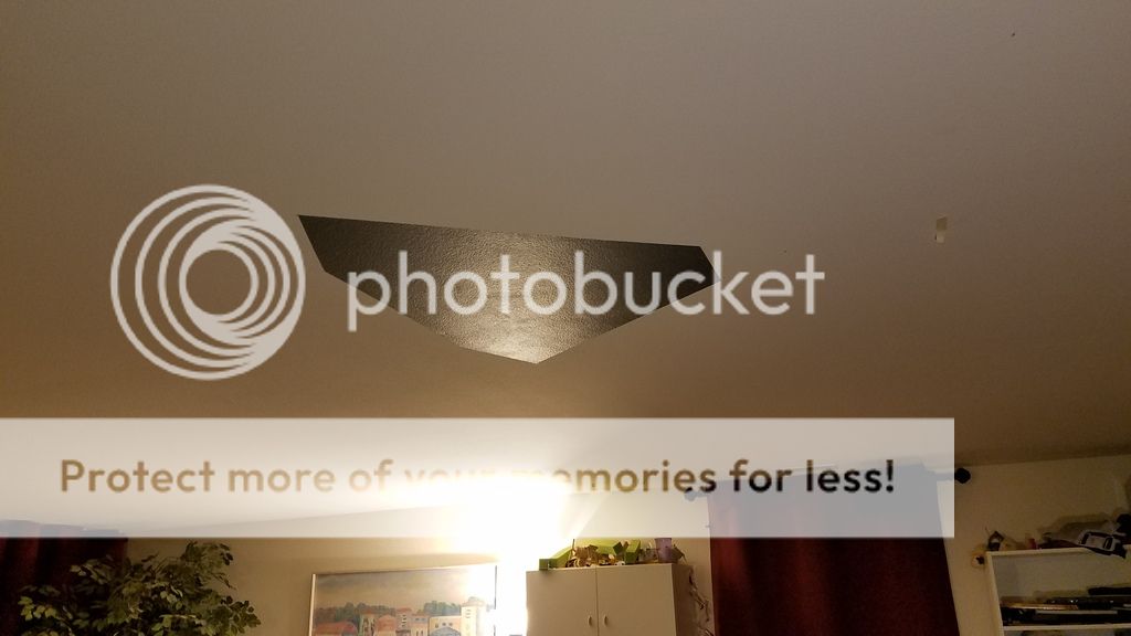

Default Should "flat" paint be this shiny???
I painted this patch dark grey, just in front of the where the projector is going (tomorrow ).
I thought "flat" paint wasn't supposed to be shiny, this is much more shiny than the white..... I am (was) going to be painting the entire ceiling in this, and the walls, 2 shades lighter grey. I did this patch because it will be weeks or months before I have time to paint the entire room.
I am very disappointed in how shiny this is, what am I missing?

Short answer, no.
Is this still fresh, wet? How long after painting did you take this photo? Latex or oil based? It might require some cure time to darken and additional coats to get it right, but when I did my room in a dark navy blue, one coat covering a base white primer looked better than that. What is your paint color, other info - can you look that up online to confirm? Using testers? I'd get another tester from different store and try again on different patch of ceiling.

Yeah, I think it could be the surface you've painted on.

Originally Posted by ImPulSive View Post
Short answer, no.
It was about 6 hours in that photo, but 2 days later, more or less the same.
It definitely reflects less light, when I shine a flashlight on it there is much less reflected light, but I am worried if I painted my room in that, the mirror like reflections would drive me nuts...
It is Valspar Signature "Almost charcoal" interior flat latex, "Base C" FWTW.
It is plenty dark, when you don't catch a light reflection...
It is painted on plain white primer... What else should I be painting on?
So how realistic is your first test? You are not going to have such bright lights pointed towards the ceiling when you are watching movies and other content are you? Have you done a real world test, darkened room and content shown to see how it looks?
Also the darker the color, the harder it is to cover up imperfections in the wall/ceiling. Just ask any painter, or get a quote on how much to paint your car white versus black. Your first picture shows bumps on the ceiling, not saying that is a defect as it could have been designed that way, but when you switch over to a dark color everything little thing will show up, which may draw your attention to it more than it would if the surface was perfectly flat. Try a real world test and see. I would also put second coat on half that area and test again.

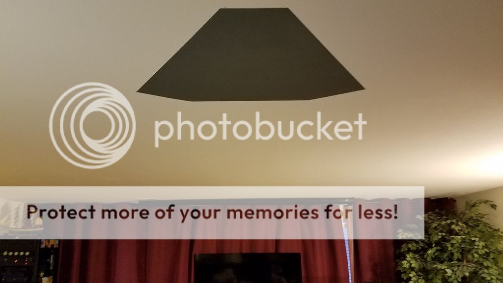

I know the ceiling has issues, not so worried about that(in this context anyway), just want to darken the room, and do it right. White is the worst thing to have on the walls of a HT. It would definitely darken the room, but this picture shows the mirror like reflections, that I think would be much worse if it went right up to the screen. I will try repainting half of it like you said.

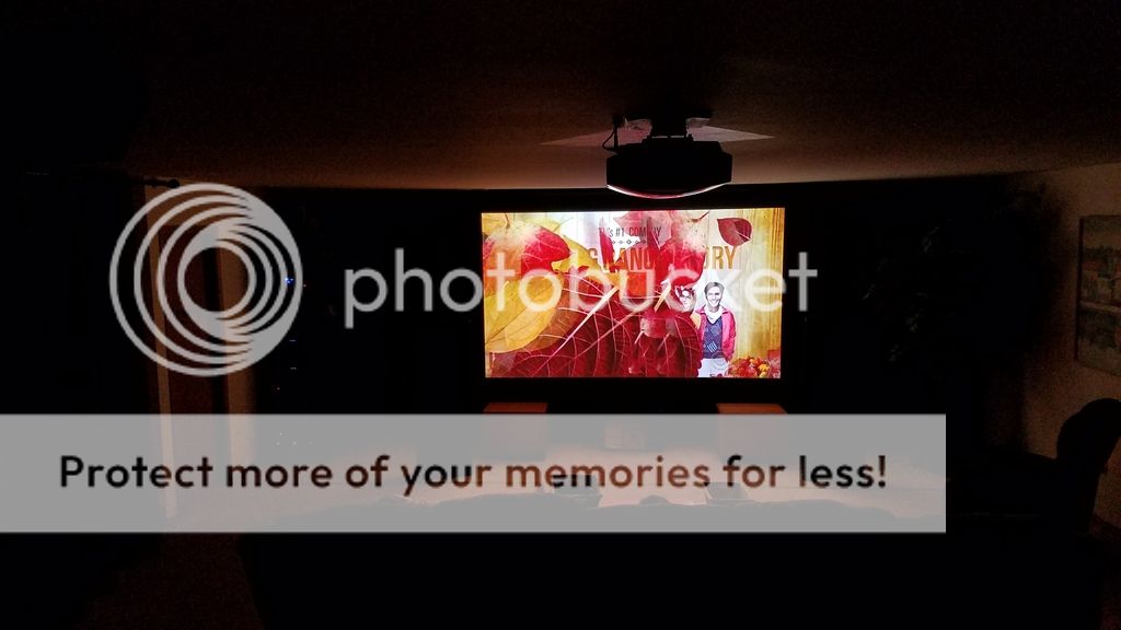

Something does not look right there...
This is what the Benjamin Moore Pre-Mixed Flat Black paint looks like in my theatre:
Flat paint is a pain to work with... if you touch it at all after it has dried it leaves a mark... since you're repainting anyway, give it a swipe with your finger... if it doesn't leave a mark then it isn't flat paint.
frogmort (11-29-2016)
Yours is more what I was expecting, I was going with dark gray ceiling and medium gray walls, as opposed to black, that shouldn't make a difference should it?
So a vote for Benjamin Moore and Behr. I will go to those places and investigate more. I initially didn't even worry about it, I though flat was flat and wouldn't be shiny. I wish I had paid more attention to that, now I have $100 worth of paint I can't do anything with.....
