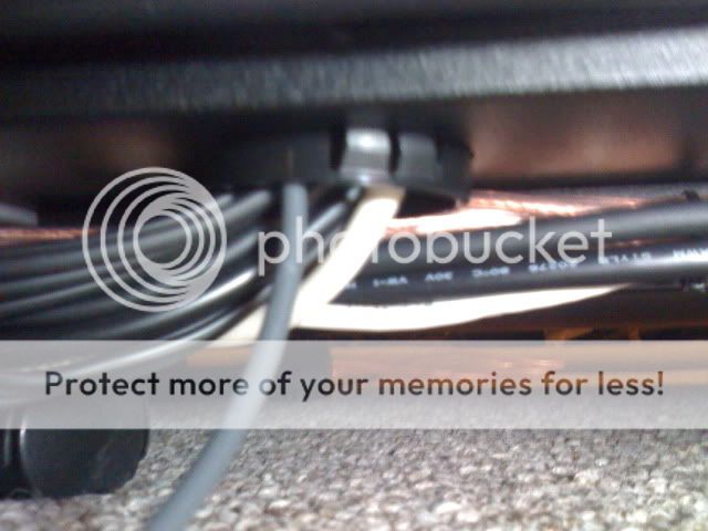

Living room updates since post #1( https://forum.blu-ray.com/3066800-post1.html )
One of the best wire management solutions( adhesive backed cable tie mounts & cable ties ).
Left bottom rear corner of TV( Panasonic TC-P65V10 ). A/V cables to TV include: HDMI, component, composite, digital optical & antenna coax.
Cables zip tied to the TV...
Run horizontal along the bottom edge...
Down the wall...
& over to the gear cabinets.
Inside view. I used my Dremel 4000 rotary tool to cut two 4" x 10" openings in the 18 ga steel cabinet rear wall.
Rear outside view.
Drilled screw holes for the grills.
Behind the receiver.
The edges were very sharp.
I used Loctite super glue gel to bond a plastic protective grommet over the edges( no more cut hands/arms ).
I used a hole saw to cut an opening, so I could route the Emotiva XPA-5 power cord outside the cabinet.
A/V cables entering/exiting the wiring holes at the bottom of the cabinets( extended rear panel ).
Cables: HDMI, component, composite, digital optical, antenna coax, XPA-5 power cord & Furman Elite-20 PFi power cord.
Cabinet rear after wire management. A HDMI & a mini HDMI cable are routed along the right side of the cabinet. They are for my living room PS3 & my camera.
Behind the Emotiva XPA-5.
I also cut a hole behind my power conditioner( Furman Elite-20 PFi ), so that routing power cables would be easier.
Ikea Dioder control & power.
Ikea Dioders mounted to the underside of the cabinet flip up doors.
Game system cable bundle( Wii, GameCube, X-box, PS2, PS one & N64, connected to a game system selector ).
Grills on.
A power extension cord for my left front speaker. One for the right front speaker is located on the adjacent cabinet. Both extension cords are plugged into the Furman, so is the center speaker.
