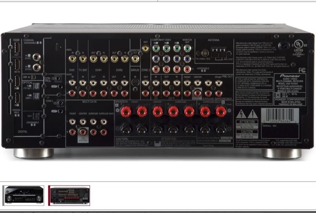

Question am i getting the most out of my speakers?
the audio equipment i own is listed below...now i am VERY new with this audio stuff, so bear with me...
the specs for my receiver state it can output about 130watts per channel, and the power capability of my speakers are about 300watts each (for the towers)
does this mean i am not listening to my speakers at their peak performance/potential? or am i just way out of my element here?
any help or explanations would be greatly appreciated guys.

I think almost everyone can benefit from seperate amplification, I certainly think you would! Pioneer gave you pre-outs on that receiver for a reason!

ok guys, explain in audio-stupid terms what you guys are referring to...because unfortunately i am lost

You have pre-outs on your receiver. You hook up a seperate external amplifier to those with rca cables to provide nice, clean, real dedicated power to your speakers. It is the shiz....
ok, what are pre-outs and what kind of amp should i be looking for?
man i need to get on this stuff
See on the right side where it says Pre Out? Those send the signal to the amplifier to play the audio. Your speakers will connect directly to the amp.

The bottom 2 pieces of equipment on my stand are amplifiers . This is what the speakers are hooked to . the amps are hooked to the receivers pre-outs !! The sound you get from an amp is cleaner ~ clearer & better sounding than what you will get from just the receiver alone !
thanks a lot for the help guys...so i hook the speakers up to the receiver (as i do now) and then take RCA cables from the receivers pre-outs to the amp?
also, why do you have two? and is there a better connection then rca cables?
EDIT: nvm, seems i connect the speakers to the amp?

Hang on Erman, ~ You hook the speakers to the amplifiers Than you hook the amplifiers to the receiver pre-outs with RCA cables !!

There are balanced connections, but that is leading into quite a bit more money. For mid level, RCA is where it is at.
Yes, the speakers connect directly to the amp. All the receiver will be doing for the channels you are amping is processing.
For me right now, I am only amping my mains with a 2 channel amp and letting the receiver power the rest. I will add a 3 channel amp down the road to power everything. You can also get 5 channel and even seven channel amps, it all depends on what you are looking for right now.

ok...let me see if i got a grip on this stuff and let me throw out some more questions (you two have been VERY helpful by the way)
1. the speakers connect to the amp
2. the amp connects to the receivers pre-outs via RCA cables
3. a two channel amp will power 2 speakers, a 3 channel amp = 3 speakers and so on (hence why i saw more than one in the pic? )
Questions:
1. can the speakers connect to the amp via banana plugs?
2. how expensive is an amp (for a setup like mine)?
3. does the brand of amp have to match like speakers do?
4. is it best to have all speakers powered by the amp or just the main ones (i.e L-C-R)
5. do i need a separate amp for a subwoofer?
Old 07-04-2009, 05:41 AM   #19
JasonR JasonR is offline
Super Moderator
JasonR's Avatar
Nov 2007
The speakers can connect via bananas.
3 channel amp, around $599. 5 channel amp, around $799. These are Emotiva prices, other amps vary in price.
It is recommended, but not necessary to match amp brands. I would be okay powering my L-C-R with one brand and my surrounds with another. I would not mix on the front soundstage.
It is best to have all speakers powered by amps, but not necessary. Running surrounds off of a receiver can be very satisfactory.
