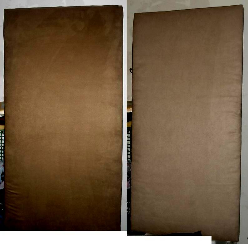

OK folks, decided to toot my own horn again. I'm not sure I like the turn out of my panels as well as I like my TV stand, but hey, these took less time....at least the first two that I've finished.
You can see quite a bit of waviness in the microsuede....but I'm not gonna let that bother me. The theatre is DARK most the time anyway. And these were much cheaper than the pre-mades I found.
Here are the first two, completed (brown on left, tan on right):

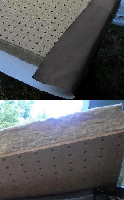

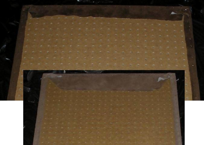

They started as Roxul panels from ATS Acoustics, spray-glued them to peg-board, covered with microsuede from Wal*Mart and there you have it....
There are a couple more pictures in my gallery.
