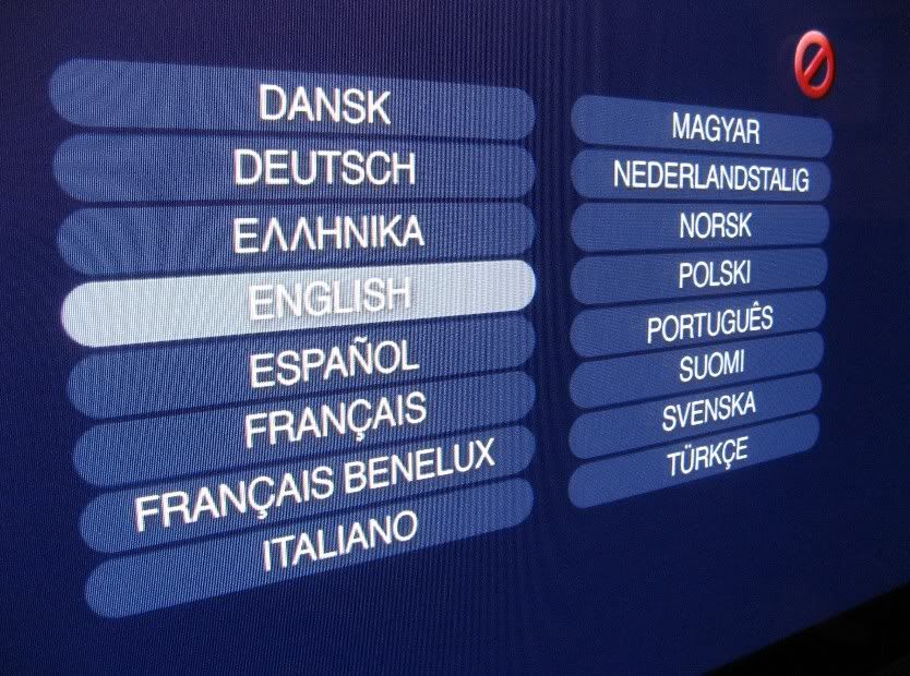

I'll check my copy of The Dark Knight shortly, but it's not just that title that the BH100 is having problems with.
The European version of Indiana Jones & The Kingdom Of The Crystal Skull will not let you move past the initial "Select a language" screen, all you get is the Red "No Go" symbol.
I emailed LG UK customer support, and they told me it must be a fault with my player.
But I imported the US version of the film, and that plays perfectly.
I would suggest to anyone thinking of buying the European Indy 4 disc (pictured on the right), to import the American one instead (pictured on the left).
Alternatively, if you load up the November 2007 firmware (071101a) from the LG website, it will let you watch the disc.....but won't let you watch certain other titles.
I have the most recent version of firmware currently loaded (080624a)-June 2008.
