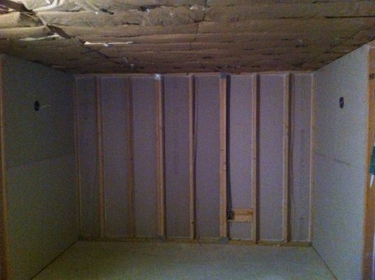

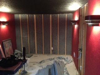

After the new walls were put up it has put the room at about 10.5 x 18.5. We used green glue for the drywall and the green glue acoustical sealant as well. Behind the painted red walls is normal insulation with the new drywall - the other walls at the front of the room and next to the red walls that have the recessed drywall just had ultra care denim insulation put in them over the weekend. Then we are going to build black velvet frames to attach to those walls. We still have to buy the wood and black velvet for those).

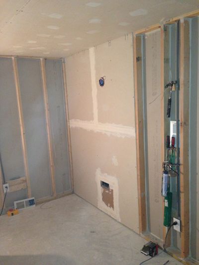

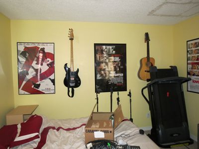

Before pics

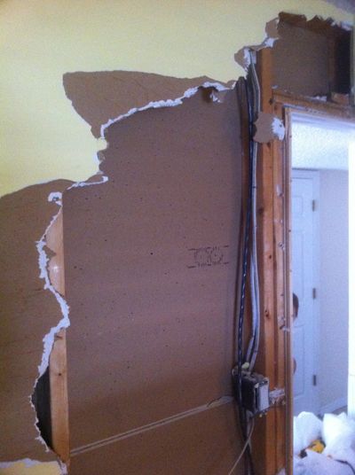

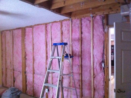

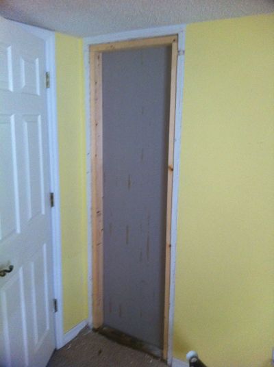

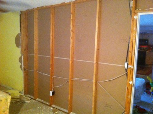

Walling up the door that used to lead to the bathroom from the guestroom
walls are coming down-

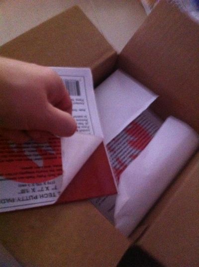

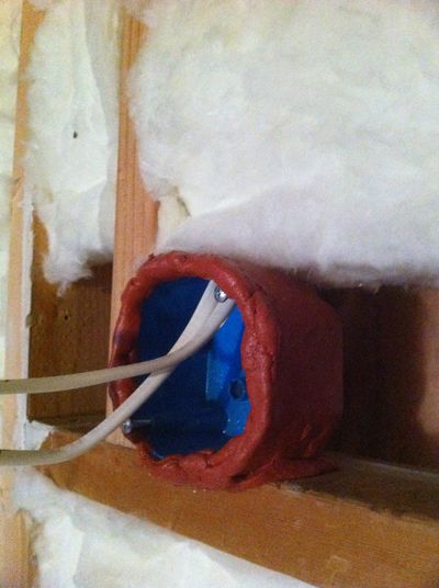

Tech Putty Pad

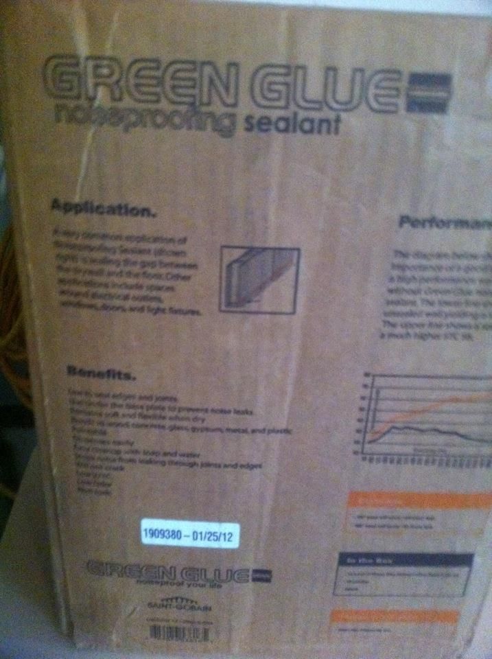

Green glue acoustical sealant

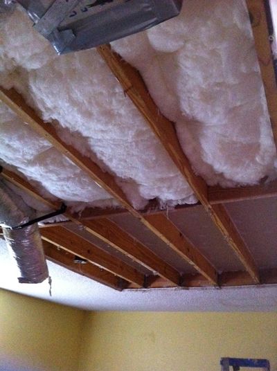

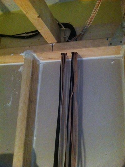

Ceiling
Back of the room:
Front of the room - screen will go here

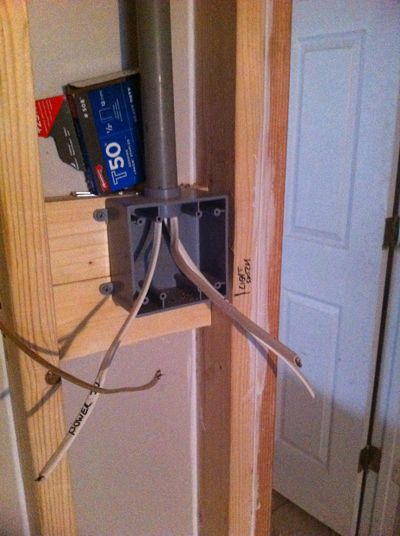

Light switch for sconces

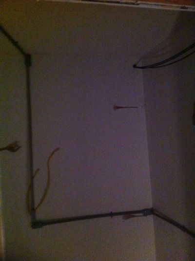

We are running the room off a 20 amp breaker we added - not pretty for now (you won't see any of it when we are done) but these are the wires running to the box.

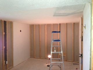

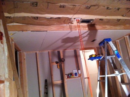

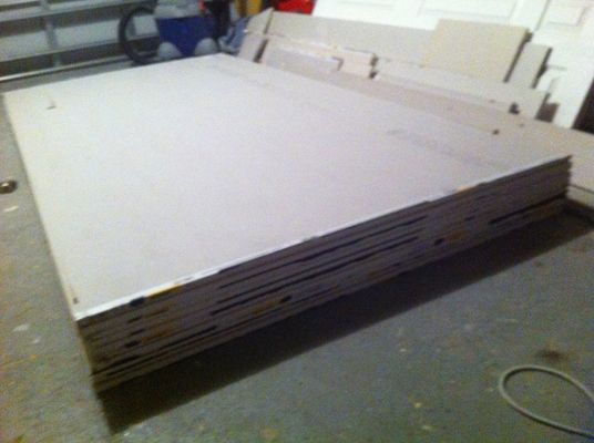

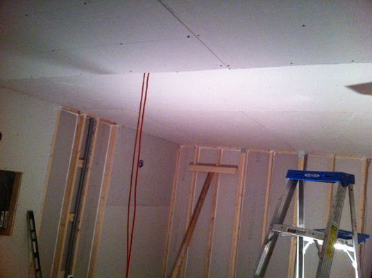

Putting up the drywall .... this was not fun - one of the times i was helping to hold up the drywall while my husband attached it to the ceiling a piece fell on my head - was glad when this part was over
Ceiling is done.

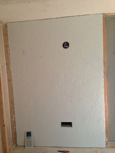

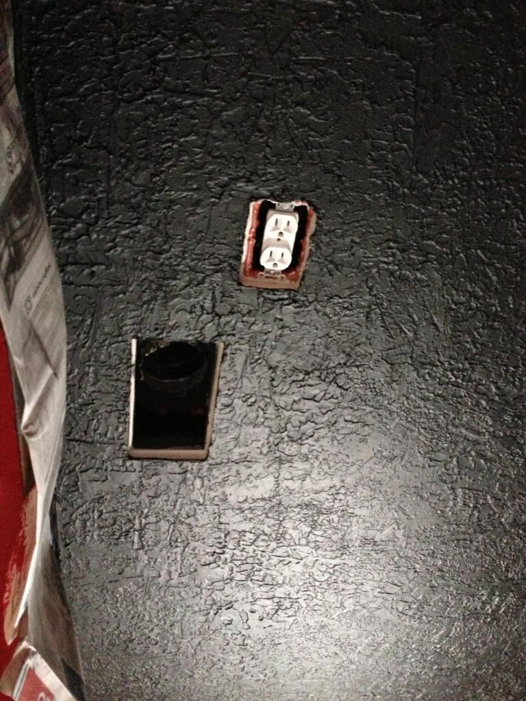

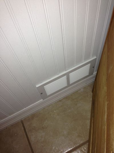

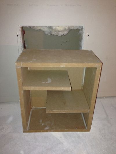

Hubby made a vent from the theater room to the adjacent room
Vent in the other room that he put in

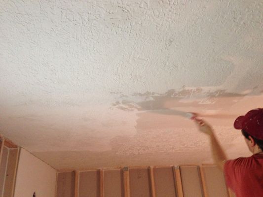

Mudding and Spackling ceiling and walls before primer/paint

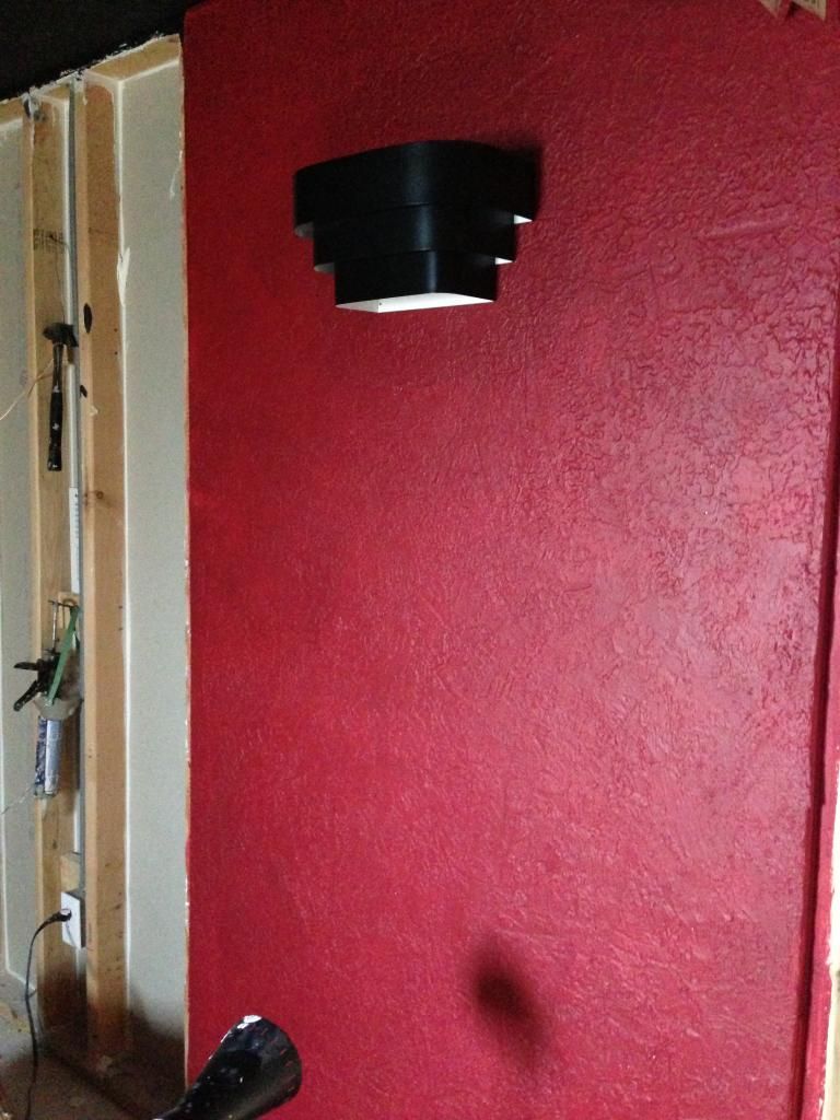

Last 2 weeks we have painted the ceiling and walls, put up sconces and started to put in denim insulation

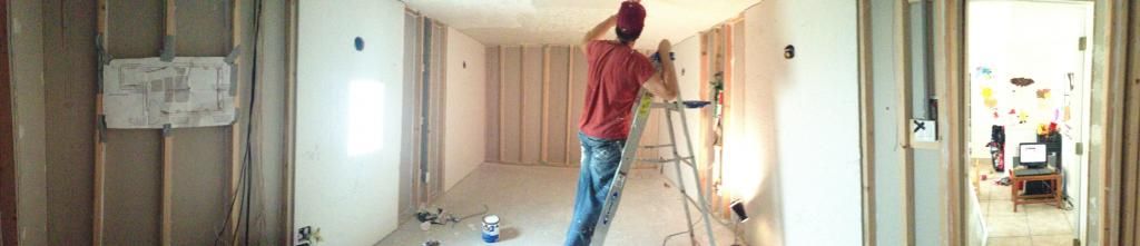

Final up to date pics ..... up til today from the last 1-2 weeks. Having the carpet installed today.
The area in between the 2 doors one to the theater room and the other
to the rest of the house. This is the part of the room that is angled
slightly so should be fun for the carpet installers today.

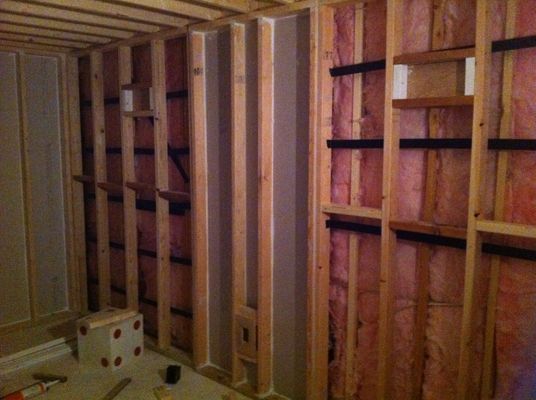

Starting to put in the ultra care denim insulation – had it shipped from
a Lowe’s in Texas – every other place on the web wanted to charge
twice as much for it plus twice as much to ship it.
