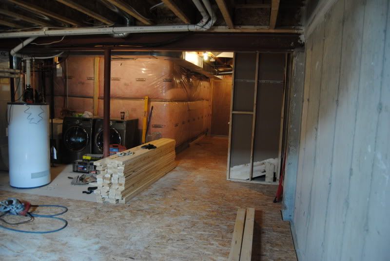

So my wife and I moved into our first house about 4 months ago. It's a new build so the basement is unfinished. I had previously had a projector setup and I loved it. Movies, sports, games, whatever looked great on the big screen.
When we bought this house I knew that I'd have to lose the space for a bit since the basement was not finished. I figured I could go a while without it. I bought a large plasma, I think I could swing it...right?
BOY WAS I WRONG...I stated getting quotes for various labour after the first 3-4 weeks. Nothing is wrong with the 64" D8000, it's some of the best PQ I've seen (I had it calibrated). I just miss having a big screen.
So I decided that I'll start this project. I will be subbing the work I can't/won't do myself.
On to the pictures...
Screen wall
Hallway to powder room and cold room
And the powder room area...

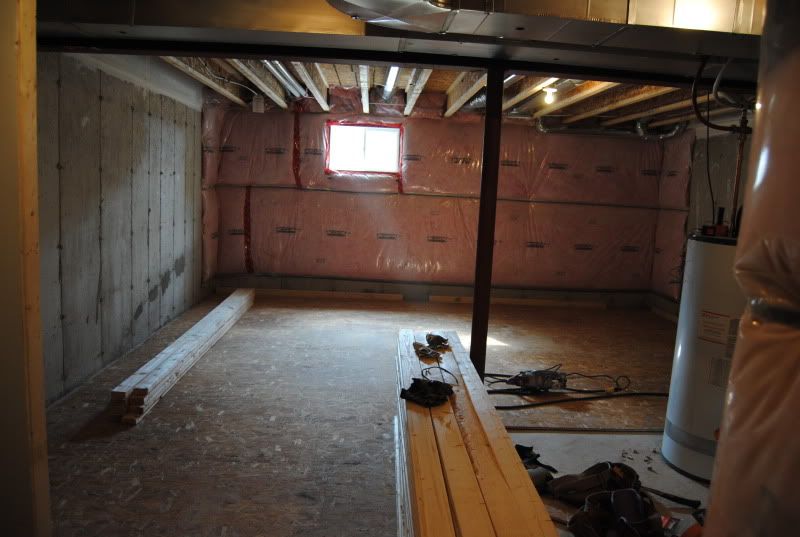

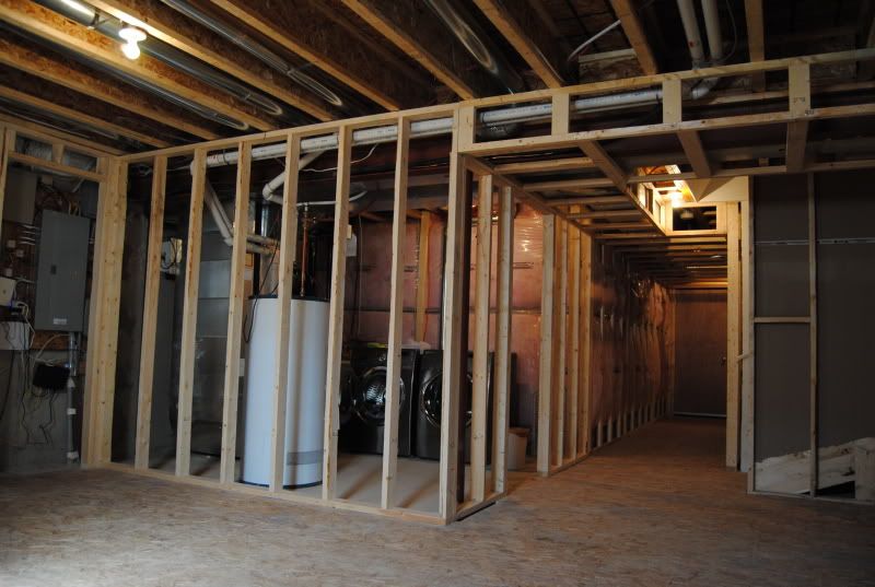

So I had subbed the framing out since I'm not about to take such a task on...It was finished up right quick. I had also decided to run a drycore subfloor in the space.
And so, we begin...
You should have seen my neighbours faces when they had seen the big box store's forklift driving down the street for the delivery. They probably though I was crazy...
Anyways, more pictures right?
The subfloor was a quick install for them...
Then on to framing...

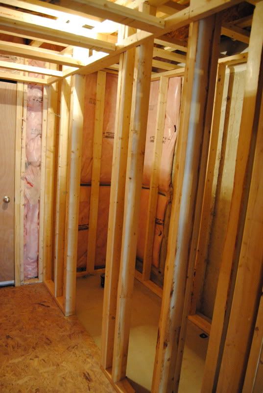

Screen wall
Powder room area...

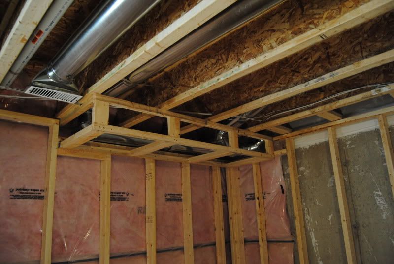

Now that I've got some time (after watching both Euro matches) I can continue with the posts

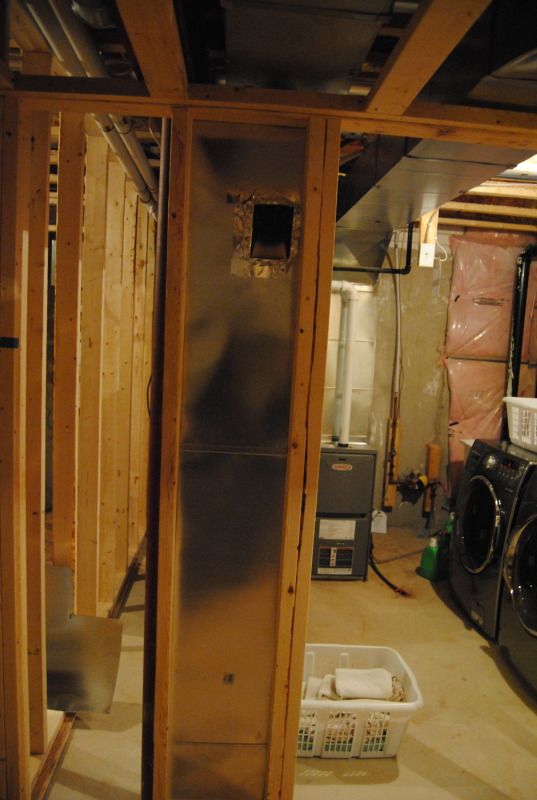

I had to tuck tape the walls leading to the cold and powder room as they had to cut into the insulation in order to get the 2X4 tight to the walls (to maximize space in the area).

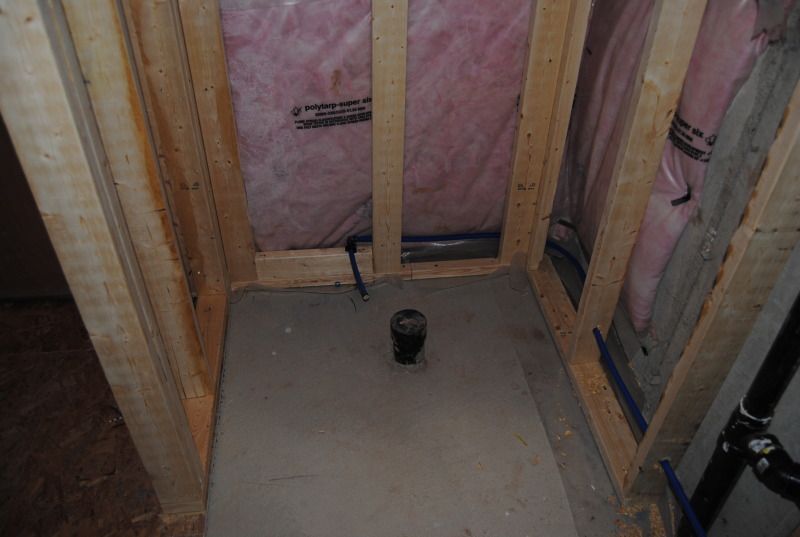

Next thing I did was I called the plumber in to tie into the hot and cold lines, as well as extend the return for the powder room.
Money well spent I'd say

And I had to close the opening and move a air return. I bought the material and went at it. This stuff is CRAZY sharp. Tin is nothing to sneeze at. I'm never doing this again, that's for sure.
I also bought a bunch of materials in order to run electrical outlets and lights...Mixed in there are gang boxes among other items needed in order to run this stuff. I'm going to start with the plugs and then do the lights second.

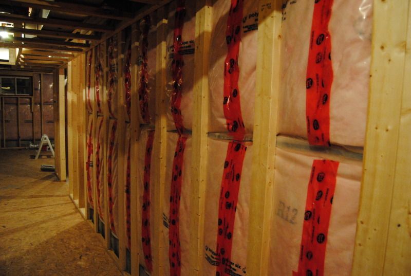

Alright folks, I've been putting in some work and it's FINALLY coming together
I was able to run all of the plug outlets.
I also ran electrical for the TV we are mounting on the wall and for the electrical tabbed screen.
I also used the good old painters tape to mess around with screen sizes.
That's 112" screen. I think I might just go 120" and not look back. We will see. I'm waiting to hear back from the manufacture on the case size and case colour. I'm looking to have a black case and not white since I've decided to pain the ceiling a flat grey colour.
I also ran electrical for the projector in the ceiling. Don't worry, I ran out of boxes so that cable will not be hanging out all alone in the ceiling. All of the electrical items in the basement will be grounded and have a dedicated breaker on my main panel.
