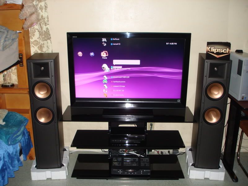

Just a couple pic's of the new speakers , They are awsome. Very happy .

wow they look awesome, especially with the grills off, good stuff man.

Take your TV off of your center speaker, never a good idea, vibrations from the speaker will pass to the TV. Also you should move your front speakers away from the wall and out past the edges of your cabinet. You should never have a large object like a TV or cabinet between the speakers, it destroys your imaging and your front soundstage.

Thanks man , They do look killer with the grills of , But with the grills on they are silent but deadly

Dude , Man 1st . not much vibrations move from the center channel to the TV. That center weighs in at 61 lbs.and trust me it does'nt move. As for what you'r saying, let me qoute you on this , you sould never have a large object between the front speakers like a cabinet or TV. If this is true where sould the TV go on the other side of them ..LOL. Please Lets say where the speakers are towed in about 4 degree's and the center channel , The soundstage is beyond awsome , more speration than the human brain could handle , Trust me man it's more than perfect. Lets put it as this , it can make you deaf ...

Try moving you front speakers 3 feet into the room, toe them in a little more, center speaker on top of cabinet tilted down to seating position and try it then. You may think it sounds great now, but it can always sound better, trust me i have a high performance set up and am always looking to improve. Also making you deaf should not be your goal if you want to set up a good system.

I think he just trying to point out that the imaging would be nicely improved if there wasn't a large cabinet right next to them. Though it might not be quite as neat, I would pull the speakers in a bit to the room, away from the back wall and side cabinets. I think it would have some improvement, for 2 channel stereo music it should have a big improvement.

first off, nice setup.
i dont quite get it when people take offense to some very good advice from some people.
second, its not a bad idea actually, just try it out, and see how much imaging can be further improved.
my suggestion?
1. mopads for the center speaker. amazingly decouples what mids it already has, and can definitely improve on voice reproduction.
2. toe em in as mentioned.

RF-82 has two rear-firing ports and moving it away from the wall should improve bass coherence, as well.

When i posted the pic's I was just showing the new speakers . I did'nt ask for any ideas for anything, actually I like it the way it is and thats all that matters right, I was just feeling happy for myself . As for moving anything , can't there's a door to the left and hallway to the right. And this is my wall in the house.LOL Thats what the wife says. If I want more realastate go buy some.LOL

We'll actually I was'nt asking for any advice. i was just sharing pi'c of my new speakers, plain & simple. I'm happy the way it is.
