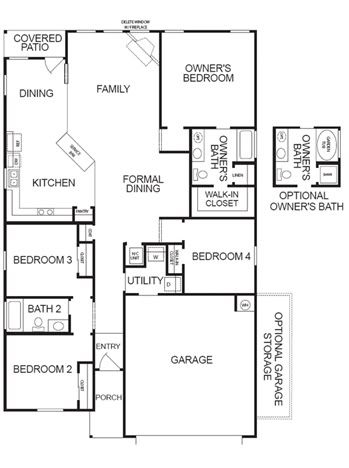

Hello all
In the process of building a house and have an option when its being built to have the family room already prewired for surround sound. would have the wires dropped from the ceiling.
Now my question is are ceiling speakers good for movies? I really know nothing about them.
thanks in advance for any advice

in family room not getting a fireplace. cable plug 6 feet up on wall with master bedroom
also have and attic so wiring through walls maybe possible

Looks like from the diagram that the floor space is open so IMO in-ceiling speakers would work well for the application of side surrounds and back surrounds for 7.1 or just back surrounds for a 5.1 since you dont have much wall space to work with on the kitchen side. The fronts and center speaker sound stage is wide open with either floor's on wall or in-walls so your preference their.

I'm not a fan of in-ceiling speakers but when you don' thave four solid walls all the way around that you could do in/on-wall, the in-ceilings might be good for your situation.
As far as the builder, they have an option they're offering you, counter their option. Specify the wire gauge w/o the speakers and give them a price. Negotiate from there.

Without four walls, as your floorplan indicates, either have in ceiling surrounds installed. Or, if you know exactly where your seating will go, you can opt for in-floor pre-wired terminals, if you prefer standmounters. I wouldn't recommend going in ceiling for the front channels though. The sound would be too indirect for the fronts.
Also, 6' up for your television pre-wiring sounds too high. The optimum screen height is eye level when your in the viewing position. If there's going to be quite a bit of standing as well as sitting, like in an open-room layout, then you might consider raising the TV height a little. 6' sounds too high though, even for mixed viewing.
Who is doing the home theater install work for you? Is the builder doing it, or is he sub-contracting to a specialist? When I had my house built, the builder sub-contracted out to Genesis Home Technologies for all HT and computer networking install work. Genesis is a local specialist that does a lot of huge home theater work in a lot of Street of Dreams homes. I don't know how I got lucky enough to get them, because I do not live in a Street of Dreams home.
Anyway, make sure your builder or sub-contractor either really knows what he's doing, including using high quality cable and installing future upgrade access points. I would recommend going for 6.1 or 7.1, depending on room size, with an alternate location away from the main gear for a subwoofer. Is your house gettin wired for a computer network too? I would recommend that as well as having good runs for HD cable and HD satellite installed to your main viewing points.
