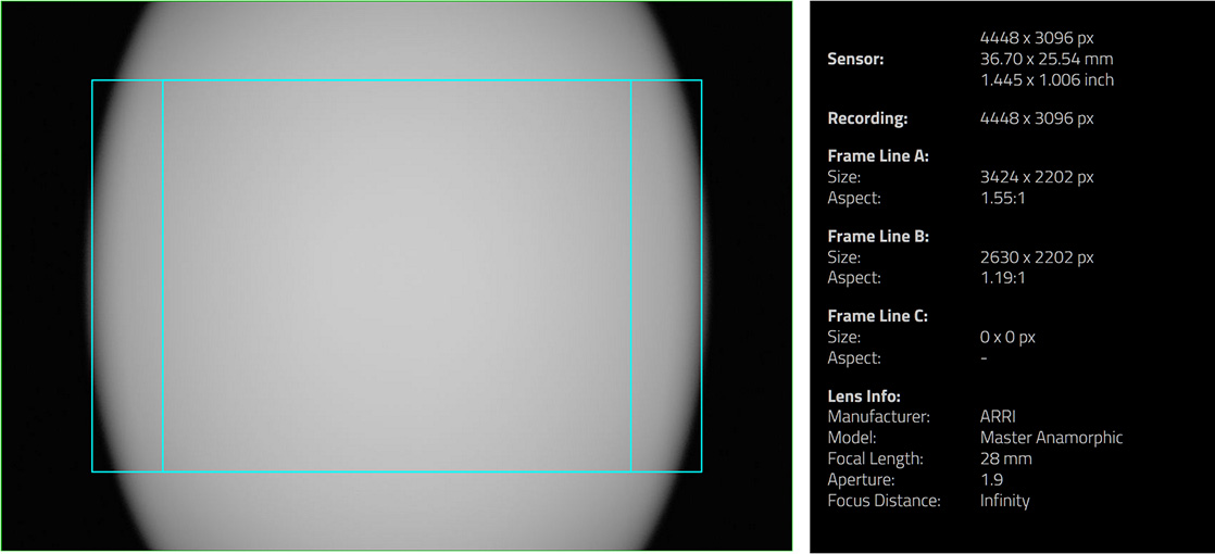

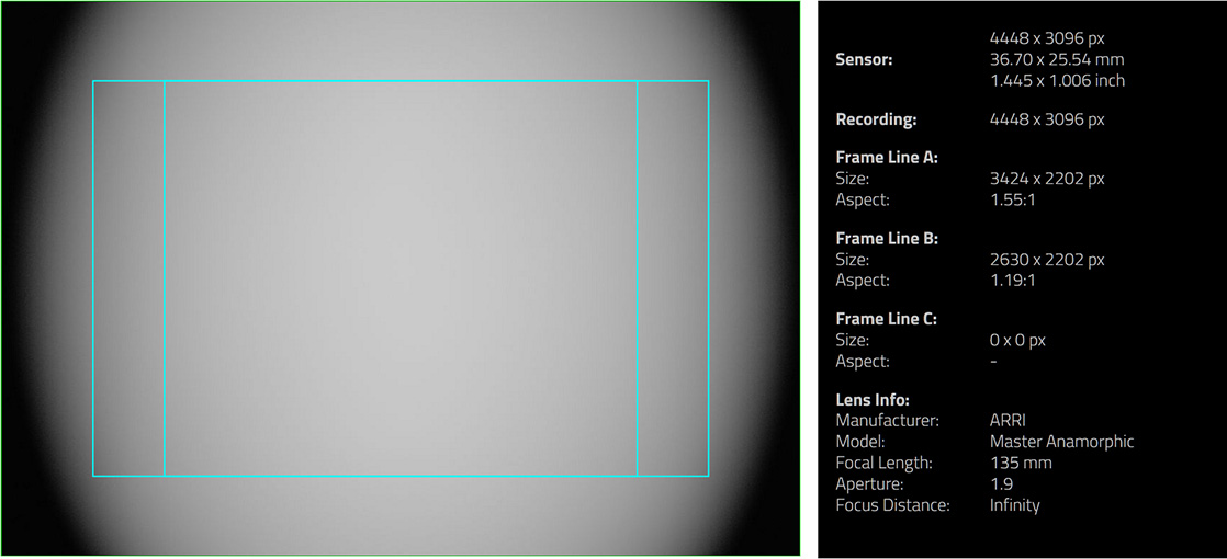

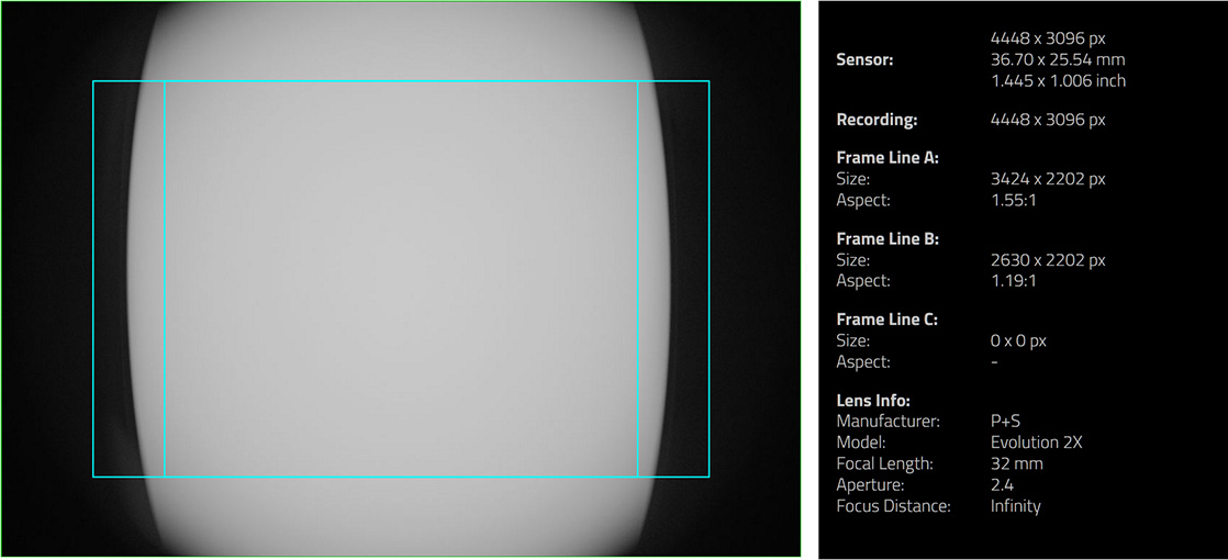

Originally Posted by UFAlien View Post
It would only matter if the lens actually covers the larger area, though. I'm talking about the physical light hitting the sensor and creating an image. The frame line tool alone doesn't take that into account and just assumes you're covering the whole sensor.
You can get a better idea from their Frame Line & Lens Illumination Tool, which is currently in beta:
https://www.arri.com/en/learn-help/l...umination-tool
Unfortunately the lens selection for the tool is very limited as of right now, especially when it comes to anamorphics. And the choice of lenses you have varies depending on camera. So there's no way to use the tool to tell for sure if the Panavision lenses used on KotM would cover a larger area than the SXT sensor. The closest you can get is checking coverage of a couple 2x anamorphic lenses on the Alexa LF, and overlaying a frame line for the size of the SXT sensor.
In the spoiler are examples I put together of this. The full image is the Open Gate Alexa LF sensor, the wider blue box is the Open Gate SXT sensor, and the narrower box inside is the maximum area used for 2x anamorphic 2.39:1 scope on the XT/SXT:
Arri's own Master Anamorphic line barely covers the SXT anamorphic scope area at its widest focal length.
Same for the only other line of 2x anamorphics the tool currently has, P+S Evolution lenses. You can see the coverage pattern is quite different as well because it varies from lens to lens even if they're both designed for Super 35.
The longest lens in Arri's series demonstrates that longer lenses have better coverage but softer edges to the image circle, which means more vignetting if you use a larger area.
So in these specific examples you could get a LITTLE bit of extra resolution on the larger Alexa 65 sensors, but not by much, and you'll run into serious vignetting if you push it. The Panavision lenses' image circles could be larger or smaller than these, though. Since they're all made for S35 I can't imagine they'd be SIGNIFICANTLY larger.
In the ASC article the cinematographer did say the 65 got them more resolution, so obviously I'll take his word for it. This is just there to show that it's probably not a major difference for the anamorphic shots (which are most of the movie).
I never understood using anamorphics on such large sensors, even if you wanted the extra resolution. If that's the case, they could've shot on the Red Weapon or on 35mm with a 4K scan.
