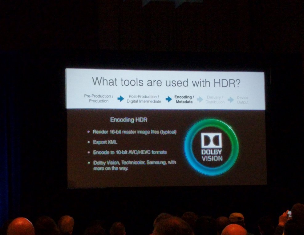

In the last step of Dolby Vision color grading, the post production facility typically creates a UHD Dolby Vision mezzanine master (MXF 12-Bit RGB JPEG2000 file + an XML) and OTT content creators like Netflix, etc. like to have it then formatted into an IMF file (depending on the frame rate either IMF Main Level 7, Sub-level 4 or IMF Main Level 6, Sub-level 3 (see p.7 - https://drive.google.com/file/d/0B37...5sMzNwcmc/view )
after which the mastering operator runs it thru a 2nd party encoder like a Dolby Vision supported Beamr encoder - https://beamr.com/vanguard-by-beamr-...hevc-codec-sdk and from that Dolby Vision IMF master, the home deliverable files are derived. As per my post above about UHD HDR streaming content, even though the transport into peoples’ homes is 10-bit HEVC, the 12-bit ICtCp mastering fidelity is maintained.
Well, yeah. It's not the encoding into a 10-bit transport stream(s) that I'm quibbling, that's just how DV works in the home (they even had 8-bit transport streams in earlier profiles) and I'm not sure I said anything to contravene that.
It's the underlying content at the master level coming up short regarding bit depth which is the issue here and I don't think that that can be argued with, no matter how much anyone would like to spin it. Kris Deering made note of Saving Private Ryan in one thread or another, saying that it's one of the few DV discs out there with true 12-bit depth from capture to master to final output.
