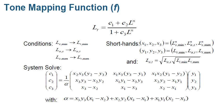

Old 03-20-2016, 01:23 AM   #73
Retired Hollywood Insider
Penton-Man's Avatar
Apr 2007
A set of standards to define the use of dynamic scene-dependent downconversion metadata is being worked on as we speak (SMPTE 2094, as mentioned in the article linked above)....
For an update (March 2nd) progress note and estimated finish date, see bar graph....
https://kws.smpte.org/higherlogic/ws...project_id=294
As I posted back in July 2015 on the 4K Movies Releases thread (to remind, after the panoramic shot I posted as an example as to the value of HDR for some stadium venues on a bring sunny afternoon [England v. Wales rugby match, which you correctly disclosed ),
the ‘ST 2094’ is about dynamic metadata (content dependent and can vary frame by frame or scene by scene). There are 4 applications in the 2094 suite of documents. For those not privy to the mostly weekly tecoms of the working group for the 2094s, this is some of the tone mapping math for Application #1(which I personally favor)…..
Last edited by Penton-Man; 11-22-2018 at 12:17 AM. Reason: reposted original pic after the free imaging hosting service I use changed urls/servers
Carlos2992 (03-20-2016), Geoff D (03-20-2016), Richard Paul (03-20-2016)
