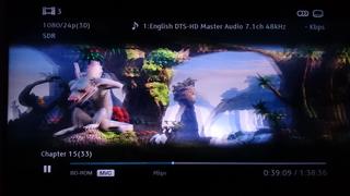

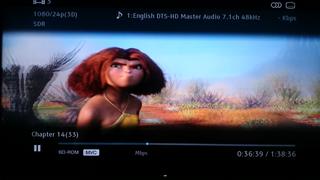

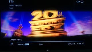

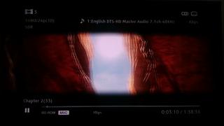

Just did a comparison for crosstalk using the 3D Blu-ray of The Croods on both my TVs:
65Z9D (ISF calibrated, pre-Oreo firmware) + X1000ES + Sony BT400A glasses
75Z9D (ISF calibrated, pre-Oreo firmware) + X800 + Sony BT400A glasses
What I did was watching a couple of random scenes, first with Motionflow (standard) enabled and then the same scene again but with Motionflow (standard) disabled. Then I played the scene in question again and paused it at random points while then toggling between Motionflow on and off a couple of times to notice the difference (if any). Fortunately The Croods 3D stays in 3D when pausing the movie (some 3D Blu-rays revert back to 2D when you pause them or bring up the pop up menu for that matter).
I did this on the 75" first and after that I did the exact same thing with the exact same scenes on the 65" (which was already on for a good 45 minutes before I started).
Btw I do notice a difference in brightness when I went from low to medium to high (and back) in the 3D glasses brightness menu. Not much, but it definitely is there, both on the 65" and the 75".
Needless to say, the double images are because of the 3D. But I've included pictures for clarification and for the onscreen info regarding chapters and timestamps.
75" without Motionflow:
Some crosstalk above the word "20th" as well in the lower left corner on the spotlight and the area underneath it.
75" with Motionflow:
Crosstalk above the "20th" word seems worse but the crosstalk on the spotlight is as good as gone (no more double image).
65" without Motionflow:
Quite some crosstalk on the entire "20th Century Fox" logo as well as in the lower left part of the screen.
65" with Motionflow:
Even more crosstalk on the "20th Century Fox" logo, the entire "A news corporation company" sentence is now a double image which wasn't the case when Motionflow was off.
Noticable crosstalk on the outerlines of the rocks on the left and right side. It has that distinctive muddy and "messy" look that I come across quite often in 3D. Also the flickering of the glasses in the sky between the rocks is quite noticable.
75" with Mortionflow:
Crosstalk is almost reduced to zero, the rocks have no more double outerlines and it looks less muddy and more "cleaner". No more flickering in the sky either.
Same as with the 75", noticable crosstalk on the outerlines of the rocks on the left and the right and really noticable flickering.
Still the same amount of crosstalk and muddy look, flickering is gone though.
It's kind of hard to describe, but the tree on the left seems to have a double image within itself. So it's not really a double image/crosstalk as if you are seeing double, but it kind of looks like there is a part of the tree within the tree if that makes any sense.
Interestingly enough, the issue with the tree remains here. No noticable improvement this time.
The tree looks a bit more muddy than on the 75" and it still shows the same issue.
Again, it looks the same to me as without Motionflow.
The trees on the left and the right exhibit some crosstalk and the branch in the upper left part of the screen is a double image (not shown here because of the OSD). Again the rocks in the middle of the screen seem to have a faint image within themselves.
Crosstalk on the trees seems slightly less but the branch is not a double image anymore. Rocks look about the same though.
Quite some crosstalk on the trees and the picture looks messy.
Severe crosstalk on the trees now, it looks like there is an entire forrest on the right because of the double imagery.
