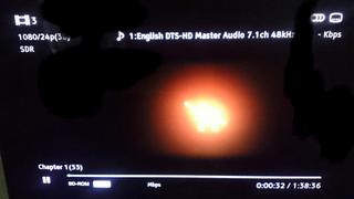

I forgot to add one picture of The Croods in my previous post:
This is at the very beginning of the movie when the fire particles start to float from the fire. I know this picture looks like shit (it is supposed to be a fire particle that seems to pop out of the screen ), but should anyone wish to check this on their 75", the chapter and timestamp is in the pic.
On the 75", without Motionflow enabled, the particle in question is a faint double image at the beginning of the scene and it becomes noticably more of a double image as it floats nearer towards the viewer. Pop out effects (and subtitles) always seem to have more problems with crosstalk (at least on Sony active 3D TVs). I clearly remember a scene from RE Afterlife for example, in which Alice throws two guns towards the screen: crosstalk galore on my first gen Sony 3D TV (55NX810) back in 2010. Anyway, with Motionflow enabled, the particle is one whole particle with just a very slight hint of ghosting withing the image itself even when it comes closer towards the viewer.
On the 65", the particle already is a double image without Motionflow. But with Motionflow enabled, it seemed like there were three particles plus looking at the paused screen at that particular moment gave me severe eye strain!

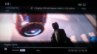

I checked a couple of scenes from Ready Player One 3D and The Hobbit: An Unexpected Journey 3D on my 75" (still on pre-Oreo firmware).
Motionflow disabled:
Crosstalk on the "scoreboard" on the left side of the screen: the lights on the left corner side of the board are a double image, also some ghosting on the right corner side of the board. The blue lights underneath also exhibit double images. All the "poles" and the "flags" they are holding in the lower middle and lower right side of the screen exhibit ghosting as well as that "blue circle thing" with text on it. Everything there in that part of the screen looks quite muddy.
Motionflow enabeld:
The scoreboard does not exhibit ghosting anymore on either side although the blue lights underneath still show faint double images. The poles, flags and the blue circle also still exhibit some very faint ghosting but certainly not as bad as with Motionflow disabeld. That whole area looks much better now, instead of a muddy mess it now looks more defined.

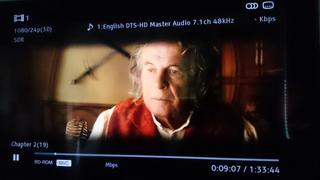

The hallway in the background on the right side behind Bilbo looks quite muddy as a whole. It's hard to make out in this picture but there's a pillar of some sort there that's standing in a vertical position. There's also a wooden crate in front of it on the floor. That whole area of the screen looks quite messy.
Motionflow enabled:
The pillar, wooden crate and everything in that part of the screen look a bit better now. It's still not crosstalk free but it looks a little "cleaner" and less murky.

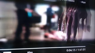

Here is a pic of My Bloody Valentine 3D taken from the opening scene in the hospital:
Either with Motionflow disabled or enabled, the bloody hand is still a double image. Enabling Motionflow did offer some improvements during the moments before this shot though. This movie has some pretty strong 3D so I think it's logical it has had issues with crosstalk.

I just tried something here, took a couple pics through my glasses. Not sure what this will even show but I figured why not. Normally I'm sitting about 9.5' away from my 65". I have Motionflow disabled, my Cinemotion is on High but from what I've read before it shouldn't matter here. I hope. I'm on current Oreo firmware.
Ready Player One
I did see slight ghosting on right side of scoreboard, very slight, I had to get closer to my screen to confirm. Left side looked great. The blue lights underneath were not doubled and the flag poles looked good. This scene looked fantastic.
The Hobbit
I could clearly see the pillar and the wooden crate, no crosstalk around Bilbo. The background was clean but also I think original photography makes it a little murky. I might check this seen out in 2D and see if its any different.
