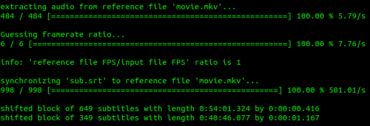

I have the subs synced now. Ran them through ALASS and all is well in the world.

By the way, this may prove useful for anyone else using external subtitles. Watch out for synch issues, even if the srt file is 100% correct.
What do I mean by that? Example, Infernal Affairs has a small chapter before the film starts to show the name of the label. In this instance some crowd called Nameless released this trilogy steelbook. The mini chapter lasts 13 seconds but then seamlessly branches to the main film file as the film begins properly. The chapter doesn't reset the playback clock to 0 though, it continues from 13 seconds!
To fix this I had to offset the subtitle timing in the external subs menu to -12 seconds (not -13 for some reason). It was melting my head why my SRT file was out of synch until i spotted the playback clock on the LCD display of the UB820!
keep little things like that in mind if you are doing this stuff for your own discs!

I find subtitle workshop very good software for altering the timing of srt files (especially when changing the fps)

I ended up doing too much work as I didn't need to use ALASS to sync the *.srt. The UHD English subtitles are spot on. The problem was the weird preroll chapter thing. Subtitle Workshop is nice though for my OCD for occasional hokey subtitles, e.g. spelling mistakes, capital letters etc.
