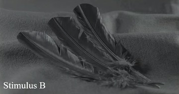

Originally Posted by Kris Deering View Post
Was there mixed content or was it a true black screen?
The stimulus image filled the entire 23” screen, like so –
Last edited by Penton-Man; 11-21-2018 at 06:12 PM. Reason: reposted original pic after the free imaging hosting service I use changed urls/servers

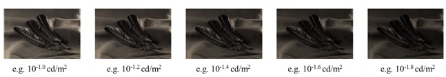

stimulus levels of the given image were shown (sent 10bit RGB 4:4:4) in a consecutive run...
Something like so -
Last edited by Penton-Man; 11-21-2018 at 06:11 PM. Reason: reposted original pic after the free imaging hosting service I use changed urls/servers
