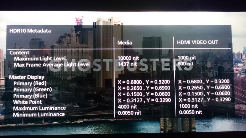

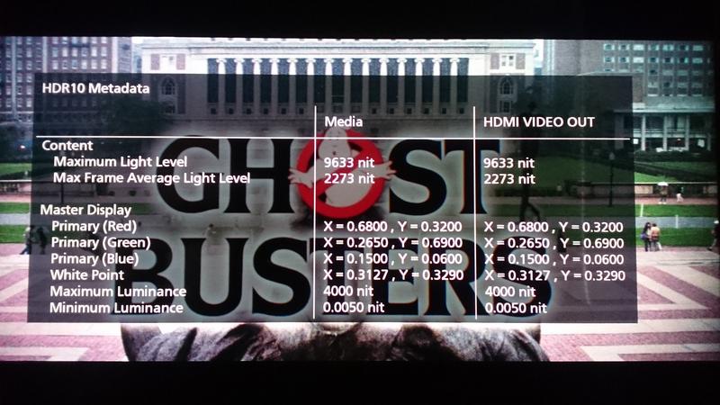

Aquaman doesn't have a peak brightness of 4000 nits, that's just the mastering display level. The Maximum Content Light Level (MaxCLL) of the actual grade according to the metadata on the disc is 3241 nits. BTW I get 1800 nits peak from my 65" ZD9 using 10% windows, but as it starts to lose a lot of colour volume at that brightness it's not actually all that useful, unless one is a total wh0re for brightness alone.
Originally Posted by gkolb View Post
FYI, 4000 is the Max on that container, in no way do the contents have to fill it.
They can have a 700 max nit movie in a 4000 nit container.
The 4000 nit mastering display level doesn't cap anything, it's exactly what it says it is: the mastering level of the display used to grade it. Doesn't mean that the content can't go lower as you say, or indeed MUCH higher, e.g.
Ghostbusters 9633 nits peak
Ghosbusters II 9887 nits peak
nuGhostbusters 10,000 nits peak
Seems kind of weird to master some content beyond your display, no? I wonder how they judge that then if it's clipped even on their own mastering displays...it probably doesn't matter since it's reserved for the smallest of peak highlights.

What's "beyond your display" is all relative, I mean if something hits 1000 nits MaxCLL then there aren't many TVs that can do that properly, never mind 4000 or 10000 nits. The transfer function used for HDR exists in a 10k nit BT.2020 container, i.e. every single thing we're watching in HDR10, 10+ or DV is encoded inside that container. Some studios stuck religiously to the early BDA guidelines that MaxCLL should not exceed 1000 nits and MaxFALL not exceed 400 nits, other studios like Sony and Warners went 'nah mate' and mastered stuff out to virtually the full 10k nits on some of their earliest titles.
While it means that our displays *now* may well struggle with such extreme content without the benefit of Dobly (other dynamic tone mapping options are available), it also means that this content is 'future proof' to a certain degree.
As to how they can master it that high if the display tops out at 4k nits e.g. Pulsar they can use waveforms to gauge what it's doing. Temporary tone mapping is also another option but that's more for <4k nit displays I think, as I recall Penton saying that they don't do temporary tone maps when grading on Pulsar.
