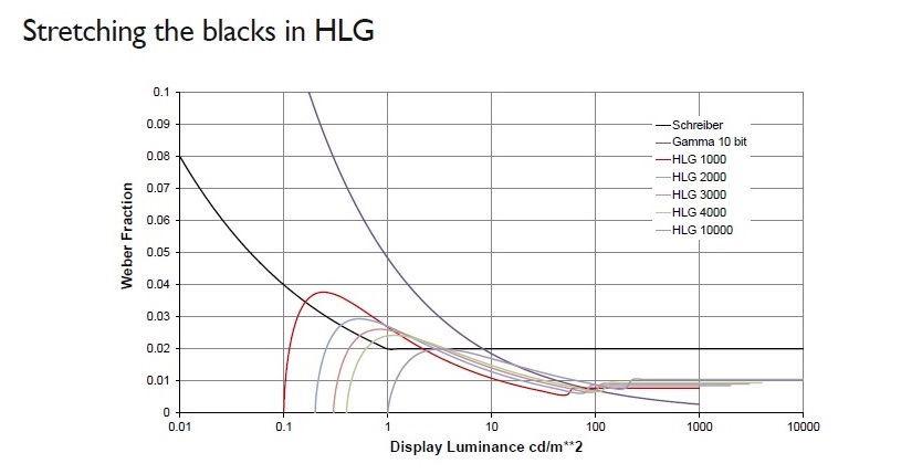

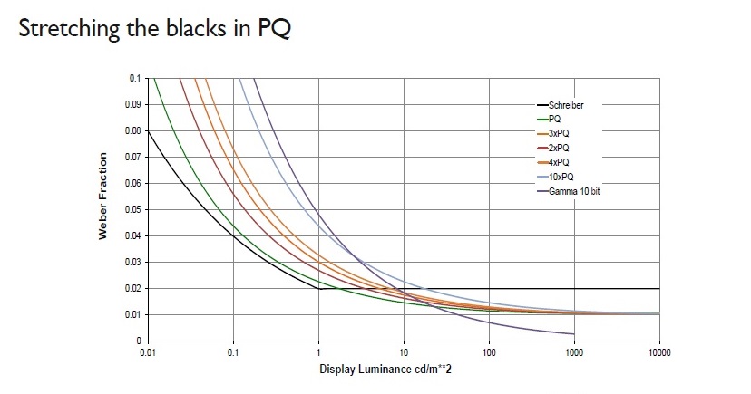

But…..HLG proponents would argue that with the PQ EOTF (of which HDR10, HDR10+ and Dolby Vision all are based upon), in order to make the image brighter for typical home viewing environments, you have to stretch the signal. If you don’t stretch the blacks you won’t see shadow in the details. So, as you try to stretch the blacks in PQ, the Weber (for definition of Weber contrast see Lecture 2 http://www.jennyreadresearch.com/201...visual-system/ )
plot moves to the right.
The Weber fractions increase and so as you stretch the PQ signal you’re more likely to see quantization artifacts in those low lights because quantization steps which were invisible in the dark images become more visible as the image gets brighter.
On the other hand, HLG was designed to be viewed in a wide range of environments (light controlled home theater, dim evening living room, bright daytime living room, etc.) on a wide range of brightness screens. And as the display gets brighter the Weber curve also shifts to the right
however, the artifacts in the low lights don’t become visible (in fact the banding performance improves slightly with higher nit capable displays) sooooo,
the contention is that HLG is more suitable than PQ to viewing on brighter displays in brighter environments, not just in reference viewing environments.
