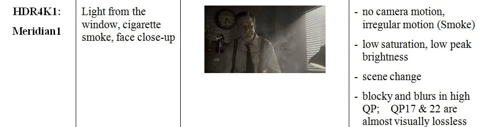

One of the more interesting scenes in Meridian to evaluate…..
Last edited by Penton-Man; 10-08-2018 at 06:28 PM. Reason: reposted original pic after the free imaging hosting service I use changed urls/servers

reaching out to Andrey Norkin at Netflix may help, as he’s quite familiar with it.
Thanks, I contacted him. Where did you get the details about the clip? Does it say anything about audio (the video has the Dolby Atmos logo in the credits)? How about HDR (both Dolby Vision and HDR10)?
To close on the Netflix Meridian issue, Andrey confirmed the version published by Netflix is Rec709. They plan to release a P3 4000 nits version of it as soon as Mozilla upgrades their hosting infrastructure (for xiph.org).

Originally Posted by zmarty View Post
Thanks, I contacted him. Where did you get the details about the clip? Does it say anything about audio....
It’s a candidate as a test sequence in standards work wrt video compression -
https://www.itu.int/CookieAuth.dll?G...on=0&formdir=7
Sorry, I don’t know anything about the audio.
