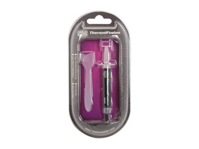

@WriteSimply, how's your PS3 working since you did that reflowing? I did the reflow process on Thursday last week and my system worked great until saturday night, but then unfortunately it looks like it overheated and shut down. Turned it back on and it worked, then came back a while later and YLOD again.
The guy who made the Youtube video recommends doing it again and doing the process for a little longer this time.
I think when I put on the two metal plates that put pressure on the CPU/GPU and heatsink, I didn't screw them in tightly enough so there wasn't a good enough connection to transfer the heat, which is why it overheated and thus YLOD again.
Ordered some better thermal paste for my next attempt, hopefully it lasts longer than 3 days this time!

Rike255 did you apply some new thermal paste? You have to remove the old thermal paste layer first. And don't make it too thick. It should be extremely thin just enough to allow the heatsink to make contact.
Well djwhetzel's method was different than mine. I studied his video for a while before I decided on my approach. To recap, 15 secs RSX and 15 secs Cell, 30 secs RSX and 30 secs Cell, then another 15 secs RSX and 15 secs Cell all at 2-inch distance. All of this AFTER a 20-40 secs warmup at 5 inch, and another 40 secs cooldown blow after the reflow at high then low temperature. AND of course, keep the heatgun moving as you don't want to over do it as to damage the chips and letting the solder flow to the other parts of the mobo. A flat working space - as flat as you can come up with - is best.
Oh you DEFINITELY have to put them back almost EXACTLY as you found them. The two metal plates that holds the heatsink/fan to the mobo must be screwed in as flat as you found them. You certainly don't want to overcrank the screws but it has to be installed properly since otherwise it won't make contact.
Like I said in my post, I put in an extra dollop of thermal paste - a drop and a half - on each chip prior to putting it all together, since I saw how much Sony used it and also how easily it seemed to spread when the heatsink is screwed in.
This is what I used. I wanted to cop a cheap one but then I figured the PS3 IS a gaming console - as well as my most prized electronics component! - that I better not go cheap.
I've used another thermal paste before and that that one was easily spread out. This one is difficult to apply because it almost dries up too fast (still not a curing one). Using my previous experience with thermal paste, I put enough to cover the chips so that the layer LOOKS like the color of the paste while still be pretty thin. AND THEN I put a dollop before the screwing in. I certainly used a lot more than a single-line of paste than the YouTube video.
