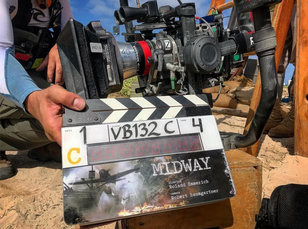

Thanks for the movie clapper pic, will post later on today. Gotta run.
Old 09-20-2018, 07:19 PM   #6758
Retired Hollywood Insider
Penton-Man's Avatar
Apr 2007
Originally Posted by Penton-Man
Note to our Hawaiian membership....If you’re in the area, stop over and send us.... a pic of the movie set.
