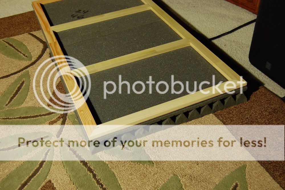

Frames I built for my ceiling panels

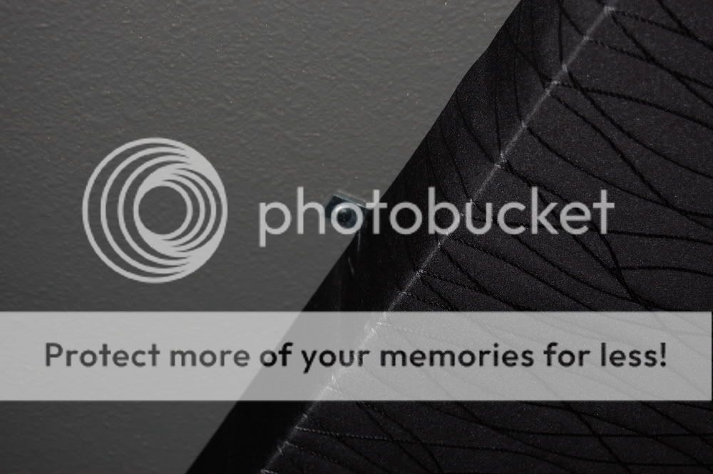

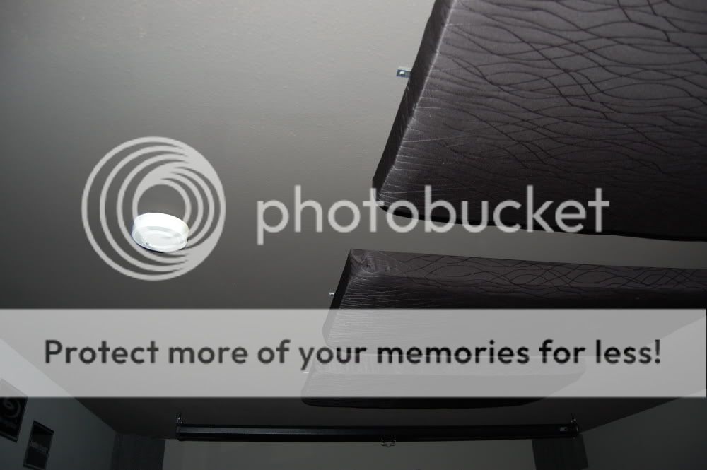

I used a flat metal bracket & screwed it to the back of the frame & then used a sheetrock screw into the ceiling . Here are the bracket & sheetrock screw
I have one at each end of the 2x4 panel & my panels are about 5 pounds so you may want to have 2 on each end for the extra weight

Lee ~ as far as the cross members are concerned, I put them there for support. I new that the panel in the middle would probably sag hanging from the ceiling. before I wrapped the material around it I used a needle & thread & secured the panel to both of the cross members. They do not sag at all & have been hanging a few months now !
