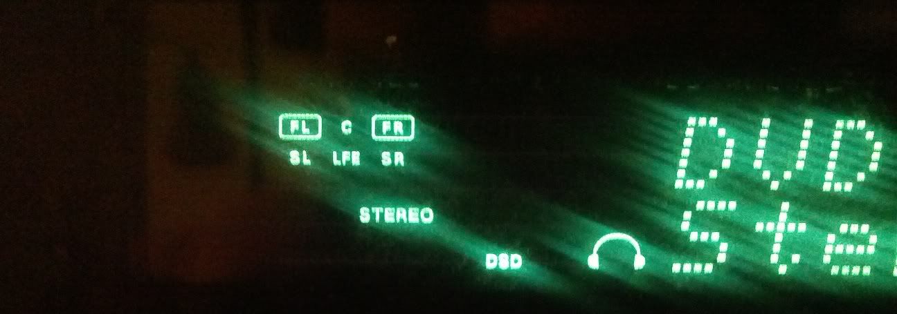

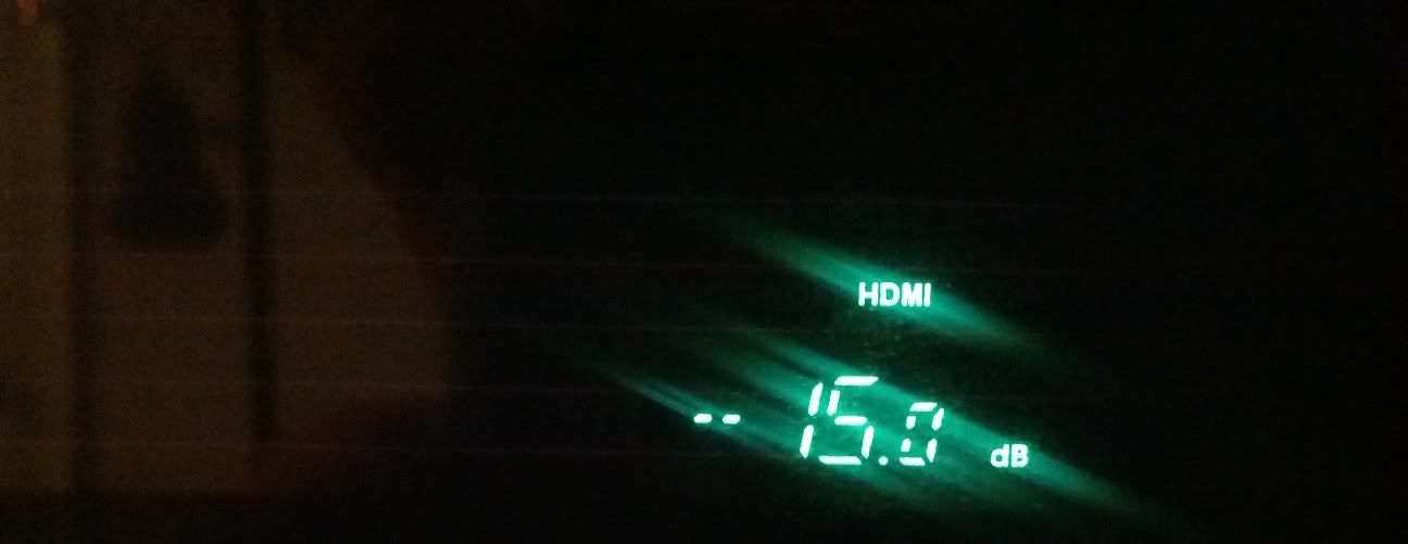

Do these answer your questions as to how its hooked up now?
Budget is tough to answer, depends if i need to upgrade my source, my reciever or both and cost vs benefit, if i could only spend $500 but you said for $1000 i would get something amazing, id save up

From what I know your receiver can handle dsd and your player can output dsd, so my take on it is no you wouldn't see a difference with another player as your Sony is just a transport, all the decoding being done in your Onkyo.
