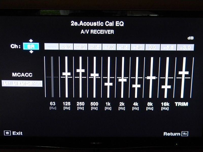

The 1021 for sure will deliver enough power to your surrounds ( btw what surrounds are you using ) and there's a easy way to compensate that by going to your MCACC manual settings and raise the trim levels , but i would run again the MCACC first ( you have several memory preset's that can be used ) and then raise the trim level on surrounds .

I saw that but it's the only one guy complaining about it ( he complains also about other stuff ) . I bought my 818 about 3 weeks ago and no issues till now and i came from several years with Pioneer .
Your receiver can handle easily the cb5 just try to raise the trim levels on your MCACC .

How do I do that on mcacc, do I have to run mcacc set up all over again or is there option I have to go into?

Here's a pic from my MCACC and on the right side you see TRIM , you just need to go to your MCACC settings and do it manually you can raise the trim on you surrounds . When i said to run the MCACC it's because you will have several memory options and you can go back and forward and listen the differences ( if i'm not mistaken it has 8 memory slots ) .
