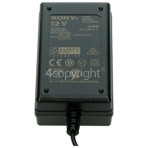

From what I know, the US player has a US AC AdapterAC-M1210UC (United States and Canada) and the UK version has a Worldwide AC Adapter AC-L1210WW (Worldwide). Both require the same 12 V DC 600mA. I'd assume as the US model doesn't need anything more, SONY have just saved money on the AC Adapter.
UK Version
US Version
AC-M1210UC United States and Canada
AC-L1210WW Worldwide

The photo of the U.S. AC adapter doesn't show its own markings like the worldwide adapter. If the U.S. adapter is marked for 100-240 VAC @ 50/60Hz like the worldwide adapter, you will just need a basic plug adapter (U.S. socket, UK plug). If it's marked only for U.S. standards (110-120VAC @ 60Hz), toss it and get a worldwide adapter, preferably from an authorized Sony UK parts dealer. I would not use any transformer other than the one built into the AC adapter.

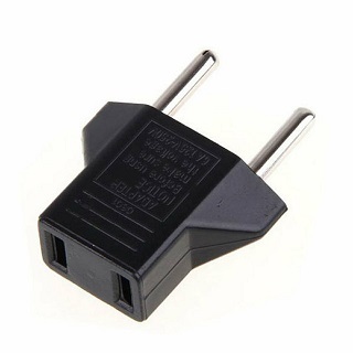

got the DMP-BD84K today, ordered it on amazon when it was USD 67.99, so in total it was EUR 93,39 incl shipping and import fee's from amazon.
I'm using a travel adapter because the plug from the LG is a bit different, I thought its an Universal plug but nope...
This one should also suffice
because the other travel adapter is too big
I guess all 12V players work fine here and in the US with the 110-240V 50/60Hz adapter.
edit, works like a charm with this 2€ EU>US Plug

Rather than risk a mod that might go wrong (especially if I needed to affix it myself) I decided to import a player that would pretty much work in the UK out of the box.
Needing a reliable company sending it that would refund any shipping back if it was damaged, I chose Amazon. Would have used others but, in this case, their in house delivery made sense.
Research here and elsewhere led me to Sony, because of their external PSU. Comparing specs in various handbooks it was clear that switching out the US PSU for a UK one would work. So no need for a voltage transformer.
The S3700 looked good but Amazon US only had a model that had the same specs and, to all intents and purposes seemed to be the same machine. That being the BDP-BX370. Less than eighty dollars and with shipping that came to around £107 using the quicker delivery option, all import taxes paid for.
It arrived within a few days, I swapped out the PSU for a UK one and it works perfectly.

Usually some on Ebay, I got mine for less than £10 but can be more or less. The model I have is the AC-L1210WW.
