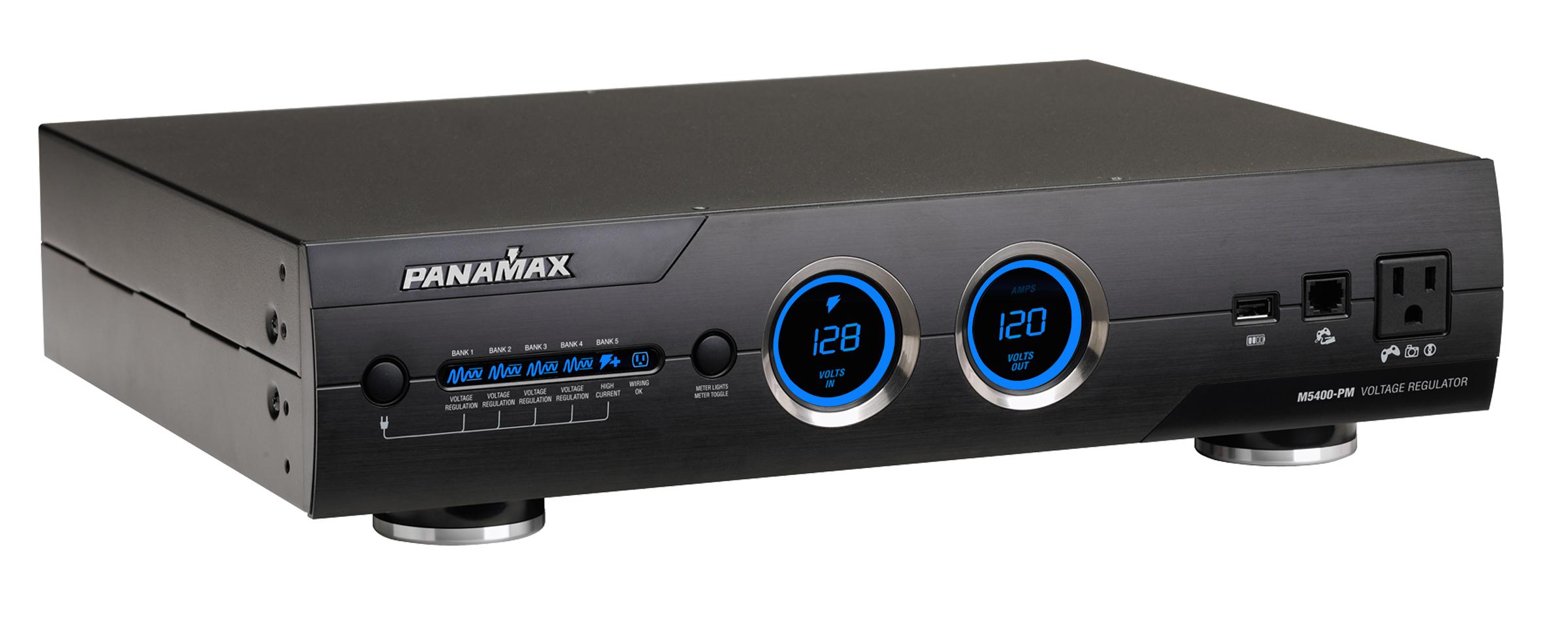

Originally Posted by IntelliVolume View Post
Guys, I'm going to ask this again, in as distinct a manner as I can...
Can anyone recommend a component-style power conditioner, such as one that looks like THIS:
...that you've been personally happy with, and that you can wholeheartedly suggest? As I said, we'd like to move from one of these:
...to one of the aforementioned component-esque pieces...
Buy a 10 outlet Brick Wall. https://www.brickwall.com/collections/audiophile
