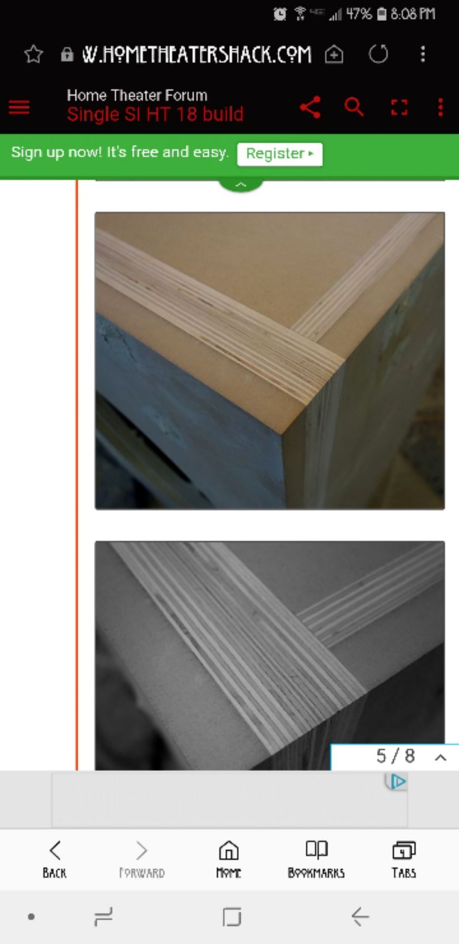

My thoughts on a build would be to consider 1" thick MDF. At least 1" on the front with a >15" driver?

I decided to go with sealed, as the UM18-22 performs better in sealed when the internal volume is less than 8ft^3, my seald cabinet that I'm going to build will be 4.01 internal volume after bracing and driver volume accounted for.
1" isn't necessary. However it is best to double up on the baffle, so in my case and most others the front baffle is 1.5 inches thick. The rest of the cabinet is 3/4" , with some bracing inside to stiffen it up so there is no flex.
1" orrrrr better

Originally Posted by Billy13 View Post
1" orrrrr better
That looks solid.
Is that your build or what you intend to build?
That looks solid.
It definately is solid. and a chore to move.
It is not my build, however I ended up with it. There was so much time and labor put into this sub. The man did a terrific job. An A+ cabinet. I cannot imagine what a manufacturer would charge for a build of this stature. I have yet to see anything.
