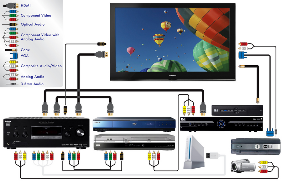

I'm not sure I am following what you mean when you say "losing some benefit" when referring to your composite connection to your computer. That should be fine. In fact, if you have a look at my gallery, you will see that I am using that connection to go into my DVD recorder. I am still using the HD DVR's HDMI connection to go to my receiver, and the signal is perfect. It is also a good signal going to my DVD recorder. So, you should be fine!
Oh and something just donned on me that you might want to try. It's called an RF modulator. With this device, you can take your composite signal and convert it to RF (coax). They're really cheap nowadays, since they're not really used too often anymore.
You would still have the issue of being limited to watching the same video, but in the situation where you're playing video games over your HDMI connection but want the PIP, this would work.
If you want *true* PIP capability — where you can watch two programs simultaneously — you need to set it up the way I explained in my other post.

Holy crap man. That is an outrageous diagram. Did you produce that on your own? By the way. I just saw you are from Santa Cruz. Both of my sisters graduated from UCSC last year. I've been up there many times and it is super nice there.

Thanks. Yes, that diagram is all me. I've made a few for other members, and some have "borrowed" my drawings and made their own; I'm also working on one for another member as we speak.

What program do you use to create your diagrams? I have the option to get many programs and would like to attempt to create my own diagram.

I used a combination of a couple Adobe products: Photoshop and Illustrator. I used Photoshop to edit the components individually (making them the proper resolution, size, clear backgrounds, etc.), and I used Illustrator for creating the diagram itself. I drew all the cable fittings in Illustrator, too. Illustrator is nice for schematics, because you can use colors quite easily and freely, and of course it's a vector-based program, which makes it easy to make straight cable runs and lining everything up correctly.
I have a lot of fun making them.
