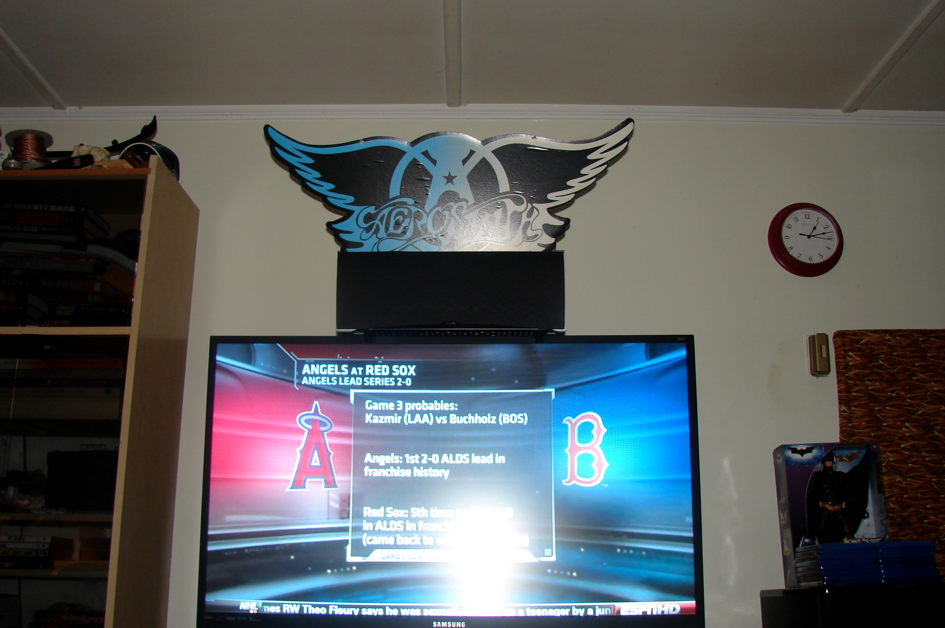

Ok. Thanks for the info. As far as what seems to be missing it's mainly the LFE. It seems to almost cut in and out randomly. I'm also trying to find the ideal placement for it.
With the center channel I made the mistake of not thinking ahead and it is positioned under my TV that is wall mounted. With just enough room. I'm assuming it would sound odd with the center channel positioned above the tv (approx 3 - 5 ft above ear level)

Could you post a picture of the front of your room.

Not at all. I have my Polk CS2 Shelf mounted above my TV, but Angled down a bit, aiming towards my primary seating area on the couch. THIS is the Mount I have ($32/Amazon), Very easy to put together, telescoping legs to help Angle your Center Up or Down. HERE is one photo of the Mount for CS2 Center Above my TV, & THIS photo gives you an even better idea.
Make sure you aim it at your listening position with the right amount of tilting.
It shoud be fine. But best is to be within a couple feet max between with the tweeters of your main Fronts (like all their tweeters).
