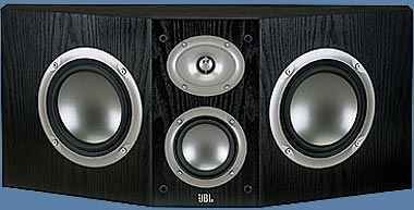

Speaker companies make their center channels horizontal because many/most people have their TV on furniture that can't house tower speakers or those tower speakers would block the view of the TV. If your layout can accommodate a tower center channel then by all means do it, but I think it's a bit dramatic to arrange your entire TV room around it or to propose that the difference between vertical and horizontal center channels is night and day. Theoretically the argument is there but practically I don't think you're suffering to keep the center horizontal.
It's not just a theory. It's been measured and tested to be true. There was a really good study on it. They found that a cheap 2-way bookshelf was better than a $300 center channel speaker.
A good coaxial speaker would be good for a horizontal CC.

Oh, it's a sound theory. The effect is real. I'm not commenting on that. My argument is that in the real world--your head isn't a microphone on a tripod--the effect isn't so dramatic as to justify designing your room around a vertical center channel. And let's not forget that shifting a horizontal-oriented MTM speaker vertically doesn't eliminate the effect, it just shifts it in a different direction. (I'm sure this is covered on the first page.) Of course this won't be a as much of a problem when the ears of all listeners are on roughly the same horizontal plane but if they were all sitting on a ladder....well that might be a problem.

3 year old thread and most all centers are still mtm. i'm look for the mtm with a slight curve and can't find hardly any.
anyone know of any budget friendly centers in the curved style?

That's due to aesthetics (MTM centers). I know of no budget friendly curved centers

My PC600's are hexagonal in shape which also prevents lobing.
Oh yeah, but are they budget friendly? Snell offered a curved center at one time also but it was costly.

This curved baffle center channel speaker from Speaker Hardware is an excellent choice.
Martin Logan makes excellent curved center channel speakers, but they are very expensive.
The shape of the baffle does not appreciably affect lobing because the woofers are still horizontally aligned and reproduce the same frequencies. They act as two point sources and will inescapably have wave interference. It may not be that audible since they're crossed over to a mid, perhaps in the 300Hz area, but how they could have prevented lobing is to beef up that mid and lose the woofers. The vertical alignment of the mid and tweeter is where your money is going to reduce lobing out of the critical zone. If they can get the mid to respond to perhaps 60-70Hz, then the majority of its <80Hz burden would then be handed over to the sub.
Which then brings the fact that if the mid and tweeter could handle things on their own, then why not match their bookshelf profile to the L/R and then have identical timbre across the front?
That Speaker Hardware may be an excellent sounding soundbar, but it can't have flat horizontal response with all those horizontally aligned identical drivers up in the critical midrange and treble zone. If it did, then you'd see some L/R configurations like that. It would sound much better rotated by 90 degrees and then purchase three across the front as vertical line arrays, although you'd still have wave interference across the crossover band.

I have listed the different options used by manufacturers to deal with MTM center channel speaker at the end of post #1. Curved center speakers is only one of the options and is used primarily by Martin Logan. Other manufacturers use other options that are simpler to build.
By far, the cheapest option is to use a two-way bookshelf speaker from the same line or place an MTM speaker vertically.
The best option is to use three identical vertical front speakers that are placed at the same height. Unfortunately, that is not practical for most people as the center speaker blocks the monitor.
