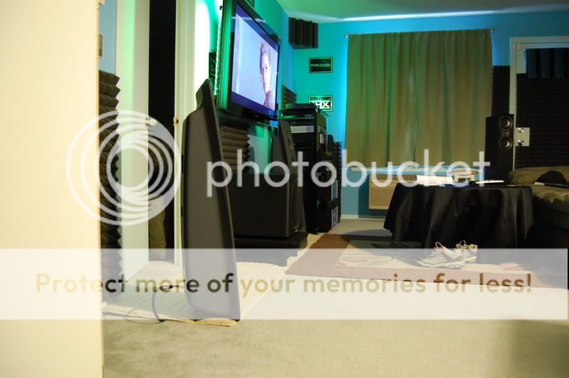

[QUOTE=prerich;5067118]Nice I read some info on his site and he does realize that you lose dynamics (unless you have the Quattro) I thought about using two more DCX2496 units to tri-amp my front array (yes I would need 6 more channels of amplification...no sweat). This would allow the DCX's to time and phase align the Heresy speakers digitally (a guy in HT Magazine did this with his La Scalas) just a thought
This is one of the reasons I went with the Quatros over the 3A signatures. With a built in sub, you can place the Quatro where it will image the best, and then "tune" the bass to that location. It has been my experience that the best place for imaging is NOT the best place for the best bass. Also, the Quatros have proven to be easier to drive, as the low bass has it's own built in sub and takes some of the load off of the main amplifier.
FWIW, adjusting the angle of the speaker to your listening position is reasonably straight forward with his instructions in the owner's manual. I was "in between" 2 of the spacers and experimented between the 2 to determine the best angle. Well worth the extra effort...
