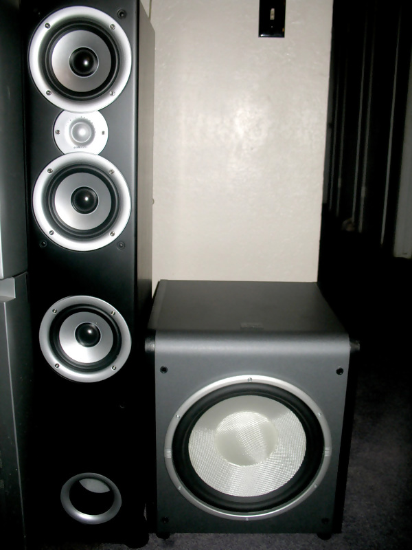

Old 04-07-2009, 04:15 PM   #321
aramis109 aramis109 is offline
aramis109's Avatar
Mar 2008
Milwaukee, WI
360
Originally Posted by parkerwilson View Post
I know, I put the mic where I show it and then I move it 3 feet to the right and then 3 feet to the left.All seats are used equel so I just use the middle of the room. I am still wondering why the front 3 speakers were -12db. Does it seem like something is wrong?
It has gain/trim levels from + to - 12db. Just seems a little odd that it's dumping them way down there. Maybe they're really efficient speakers- I'm not really that familiar with Klipsch. The most important thing is how it sounds now, however.

So, far testing my Acoustic Audio HD-SUB 12 (again, thanks for the recommendation Big Daddy) and putting it through the "Quantum of Solace" test and "Transformers" test and so far so good!
I do have a technical question. I have a 7.2 setup but I was wondering for an Onkyo 606, is it best to keep the front speakers to full band and let everything go to the subwoofers?

It's more dependent on the speakers than the amp as to what to run your crossover at. I'd recommend running your fronts at least at 60hz. I ran them at 80hz- let the sub take that low end stuff.
Congratulations on your new sub. Now I know who has been buying the kick-ass 15" subs. No wonder why they are out of stock.
From your picture, I am not sure that is the best for your subwoofer. With two subwoofers, you need to experiment. Try to put the big sub up front in the croner, a couple of feet away from the walls, and put the RCA subwoofer closer to your listening are (e.g., behind the sofa or on the side). See if you get good results. Go to the end of the original post inA Guide to Subwoofers (Part II): Standing Waves & Room Modes and also to the begining of Post #2. There are some diagrams on where you should put two subwoofers.
It is a good idea to let the subwoofers take care of the low frequency sound. Aramis is correct. Set the crossover of the fronts to 40Hz or 60Hz and decide which one gives you better sound. Don't forget to set the volume gain dial on the back of the subwoofer to 50% point, no higher than 75%. Make sure the crossover dial is set to its maximum point. You take care of crossovers in the receiver's menu.

Whoah...thank you guys for pointing the error on my sig....it's the 12 that I have not the 15. Yikes.
Big Daddy, thanks for the information for subwoofer placement. I bought a 12" RG6 from monoprice.com and I'm about 12-13 ft. away from my television, so I'll order a 25 footer. I never had a subwoofer that close near my sitting area but willing to give it a try.
Currently, my setup is like this:
So, the ideal placement would be something like this?
Until I buy a second powered subwoofer, subwoofer #2 (the 12" unpowered one), would it be best to have that at the front or the back? Keep the Acoustic Audio powered one in the front?
Thank you BD and everyone else for their help and suggestions.

Ideally two identical subwoofers work the best. Until you get another identical sub, try option 3 and see how it works. However, it doesn't hurt to try all the options and see which one will give you the best results. In all cases, keep the subwoofers a couple of feet away from the wall. This is very important for the Acoustic Audio HD-Sub 12. Its port is in the back and you should keep it at least 2 to 3 feet away from the wall. Also make sure you adjust their levels so that one sub does not overpower the other one.
  1. Put one sub in the middle of the right wall and one in the midle of the left wall.
  2. Put one sub in the middle of the front wall and one in the middle of the rear wall.
  3. Put the bigger sub in the front corner and the smaller sub near your sofa (right, left, or behind the sofa).
  4. Put one sub in the front corner and one diagonally opposite in the rear corner.
Remember that all rooms are different. There is not one size fits all position. You should be patient and experiment.
