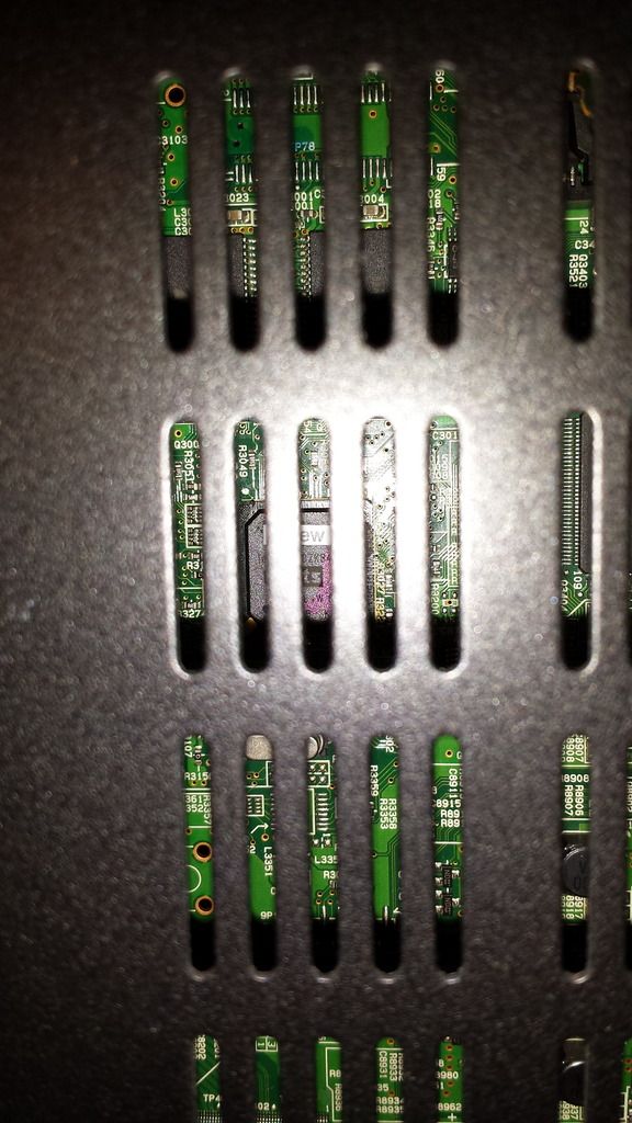

So after 3.5 years my 818 has got this dreaded issue =(. Got home today and turned it on, video but no sound. The speaker indicators were not showing up on the display, no sound even from the test tone menu. Since I bought it as a refurb from Accessories4Less I was in doubt that this program would cover it but went ahead and entered my info and it said it qualifies thankfully. Awaiting my shipping materials now.
So for anyone who has had the repair done, how was the process? Is it still working? Also I read a thread on AVS forum and one poster showed pictures showing that Onkyo is replacing the HDMI board with new boards that have an updated TI DSP chip with better specs so hopefully the issue won't occur again, can anyone here confirm this? The picture the guy posted showed that if you got the new chip it should have a "U" on it made with what appears to be marker and a white label with the word "new" on it.
New Chip:
Old Chip:
